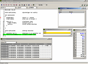

Using Insight (Windows)
After you have started Insight (c:\msp430\bin\msp430-gdb.exe), click on "File->Open" and select the elf-file (e.g. "test.elf") you want to debug.
Now click on "Run->Connect to target" and enter the following settings:
   Target:                   "Remote/TCP"
   Hostname:                 "localhost"
   Port:                     "2000"
   Set breakpoint at 'main':  yes
   Set breakpoint at 'exit':  yes
   Attach to target:          yes
   Download Program:          yes
   Command  after attaching:  "monitor erase all"
   Run Method:                Continue from last Stop
When you click on "Ok" Insight should tell you that the connection was successful, and gdbproxy should say "notice: msp430-gdbproxy: connected".
To start the debugging click on "Run" or simply press "r". If everything worked correctly you should now see the sourcecode of your program with the first line of main() marked green. The red point is the breakpoint that has been set by Insight automatically. You can set or remove breakpoints by clicking on the '-' in front of the line.
Now you can 'c'ontinue the execution to the next breakpoint, 's'tep through the code, or step a single assembler instruction... but be careful with "finish": Insight sometimes seems to lock up with this command. So if you want to finish a function, I recommend setting a breakpoint to the end of the function and using "continue".
