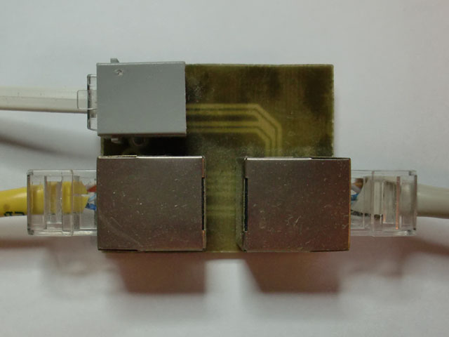

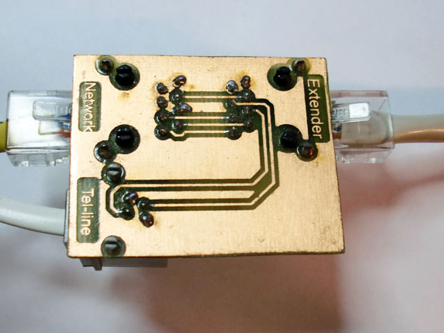

Hi, Several years ago, I created a single-sided PCB, especially for this purpose. I use this system for sharing telephone and ethernet (100 MBit) over 1 (CAT5)line. The PCB is unprotected, or at least, have some plastic spray as protective cover. I've included a picture of the top and bottom of the PCB, so you can verify it. People might suggest, 100 MBit will not work. Fine to me, but at least here it works. And,.. I've included this PCB, which was designed in an older Eagle-version as brd- and sch-file, next to a PSD-file for Adobe Photoshop to print it out and make your own PCB. Just my 2 cents (for this community). P.S.1. CAT5 cable runs here from cellar to attic and is about 20 meters in length. P.S.2. After posting, I noticed the schematic-file contain 2 links. You might notice I'm Dutch. P.S.3. If you appreciate this message / contribution, please mark it as "lesenswert".
