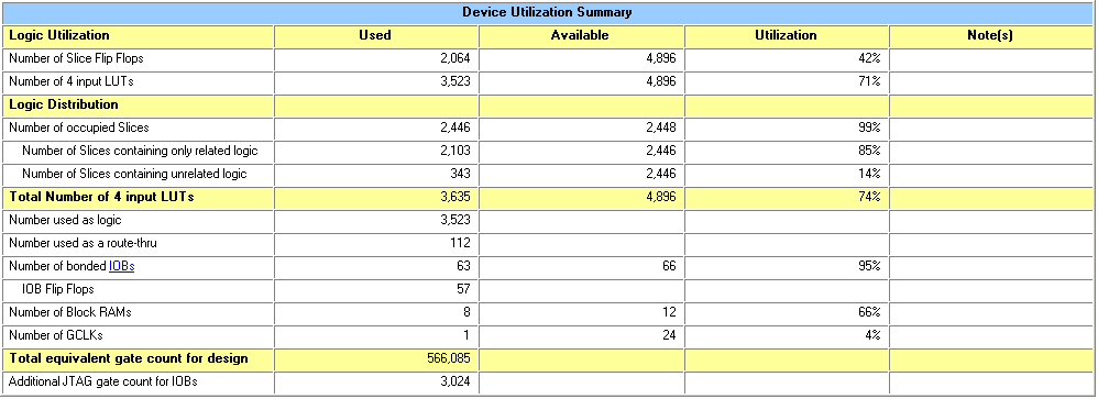

Im Anhang sind die Ausgaben der Design Summary des aktuellen Projekts
dargestellt. Kann man da relevante Infos daraus entnehmen?

Und hier noch ein paar "Auslastungszahlen" der Synthese/Implementation:
Synthesis Report
Found area constraint ratio of 100 (+ 5) on block KUSB_IO_FLEX, actual
ratio is 91.
Device utilization summary:
Selected Device : 3s250evq100-5
 Number of Slices:                    2328  out of   2448    95%
 Number of Slice Flip Flops:          2121  out of   4896    43%
 Number of 4 input LUTs:              3631  out of   4896    74%
 Number of IOs:                         63
 Number of bonded IOBs:                 63  out of     66    95%
 Number of BRAMs:                        8  out of     12    66%
 Number of GCLKs:                        1  out of     24     4%
Map Report
Design Summary
Logic Utilization:
  Number of Slice Flip Flops:       2,064 out of   4,896   42%
  Number of 4 input LUTs:           3,523 out of   4,896   71%
Logic Distribution:
  Number of occupied Slices:                        2,446 out of   2,448
99%
    Number of Slices containing only related logic:   2,103 out of
2,446   85%
    Number of Slices containing unrelated logic:        343 out of
2,446   14%
Total Number of 4 input LUTs:          3,635 out of   4,896   74%
  Number used as logic:              3,523
  Number used as a route-thru:         112
    IOB Flip Flops:                    57
  Number of Block RAMs:                8 out of      12   66%
Place and Route Report
Design Summary Report:
 Number of External IOBs                          63 out of 66     95%
   Number of External Input IOBs                 35
      Number of External Input IBUFs             35
        Number of LOCed External Input IBUFs     35 out of 35    100%
   Number of External Output IOBs                20
        Number of LOCed External Output IOBs     20 out of 20    100%
   Number of External Bidir IOBs                  8
        Number of LOCed External Bidir IOBs       8 out of 8     100%
   Number of BUFGMUXs                        1 out of 24      4%
   Number of RAMB16s                         8 out of 12     66%
   Number of Slices                       2446 out of 2448   99%
      Number of SLICEMs                      0 out of 1224    0%
Starting Router
Phase 1: 18715 unrouted;       REAL time: 2 mins 33 secs
Phase 2: 17345 unrouted;       REAL time: 2 mins 38 secs
Phase 3: 7254 unrouted;       REAL time: 2 mins 45 secs
Phase 4: 7254 unrouted; (1363)      REAL time: 2 mins 47 secs
Phase 5: 7275 unrouted; (1274)      REAL time: 2 mins 51 secs
Phase 6: 7277 unrouted; (0)      REAL time: 2 mins 53 secs
Phase 7: 0 unrouted; (0)      REAL time: 3 mins 29 secs
Phase 8: 0 unrouted; (0)      REAL time: 3 mins 34 secs

Gast #1038289
Naja Du hast unrelated logic angeschaltet. Das ist gut, da platzsparend,
daher gehe ich davon aus dass die 99% Slices realistisch sind. Dagegen
eine Auslastung ähnlich des Maximums aus Anzahl_ff und _LUT anzunehmen
ist falsch. (bei Virtex5 mit 4 LUT/FF pro Slice sieht das anders aus).
Wobei ich allerdings immer auf Fläche bzw -balanced optimiere, da das
die besseren Ergebnisse bringt
(vorausgesetzt der der Takt ist nicht pervers hoch).
Ermittele doch die Flächenauslastung experiementell, Bau testhalber ein
paar Counter oder ähnliches in einer Generate schleife ein und taste
dich so an die NoGo-Grenze ran. das ist eine praktische Näherung, alles
andere sind nur theoretische Kennzahlen. Und bei Deinen 99% sollte man
sich wirklich diese Zeit nehmen, um den bedenken nachzugehen.
Gast #1038300
BTW, persönlich würde ich hinsichtlich der LUT-Auslastung von 74%
(inklusive der route thru's) ausgehen, nicht von 71% (Logic Utilization
only).
Jedenfalls ist es mir und den FAE 2005 (ISE 6.*) nicht gelungen die
route thrus wegzuoptimieren. Und die Ursache für diese konnten wir auch
nicht finden, es sah so aus als ob beim Spartan3 und unseren design
Signale unverknüpft durch eine LUT geführt werden müßen. Aber vielleicht
löst sich das Problem, wenn Du auf Area optimierst.

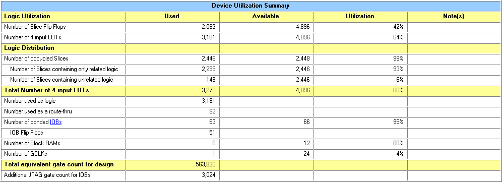

OP #1038319
ich habe nun mal den Synthesizer auf "area optimized" mit "effort high"
eingestellt, dabei ist das Bild im Anhang raus gekommen.
Habe ich nun ein Platzproblem?
Ich glaube nicht, denn ich habe testhalber schon ein paar Instanzen
eines grösseren Funktionsblocks zusätzlich eingefügt gehabt, das hatte
geklappt.
Wie aber kann der Füllgrad des FPGA z.B. von BMW auf 80-90% spezifiziert
werden, welche Zahlen sind dafür zu beachten?

OP #1038770
ehk wrote:
> Ergo ist die Auslastung der Slices zu vergessen und
> dafür das Maximum von LUT oder FF-Auslastung zu nehmen... Die BMW-Spec
> stammt noch aus Zeiten, in denen die Slice-Auslastung das maßgebliche
> war. Man lernt halt nie aus....  Also Du kannst wohl doch von 74%
> ausgehen.
Das ist mal eine Ansage, danke!
Die Auslastung wäre dann beim mit "area optimized" mit "effort high"
implementierten Design bei 66% nach deiner Interpretation.
Ich muss aber wohl davon ausgehen, dass ich das FPGA nur bis ca. 75%
füllen kann, denn bei diesem Versuch (siehe Anhang) mit Zusatzlogik
schaffte es der Mapper nicht (wohl wegen "number of occupied slices" =
103%). Allerdings wurde diese Variante mit "speed optimized"
synthetisiert.
Dann gehe ich bis auf weiteres davon aus, dass ich noch "Reserven" habe,
wenn die "Total Number of 4 input LUTs" noch unter 75% liegt. Ist das
wohl ein einigermassen sinnvoller Kennwert?
Oder eher so? Wenn beide Werte "number of slice FFs" und "number of 4
input LUTs" kleiner als 75% sind, dann habe ich noch "Luft".
oder
