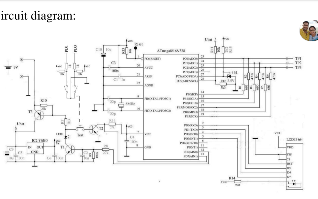

Transister tester doesnt boot power comesvto both display and microprocessor only when switch pressed movement remove the fingure power cutoff please help me totrouble shoot the problem

A few hints: 1. those funny looking characters help the readers a lot: .,:;!? 2. did you have a look at your video before sending it? 3. add some information: did the tester run till yesterday and now ist faulty? Or did you build it and got this behaviour? 4. what supply do you use? did you measure the supply voltage at failure?

This just after build Supply given by power supply it read as 8.6v if press long enough I removed the display and processor both but stll power not delivered continuesly even with 9v battery result is same

Here is the video clip to demonstrate the problem I have two circuits with same problem please help Leuchtet die rote Led auf? Im Video sieht man sie nicht.
#5104947
No Die Led ist verdreht eingebaut oder defekt?
#5104953
This is the circuit diagram hope this will help to find the cause If the LED-polarity is wrong, the circuit wohnt work. It has TO shine, when Switch is pressed.

Thank you everybody who try to help me problem solved. LED Polarity was reversed Carl Drexler specil thank to you for your kind instructions for trouble shooting Antwort schreiben |
