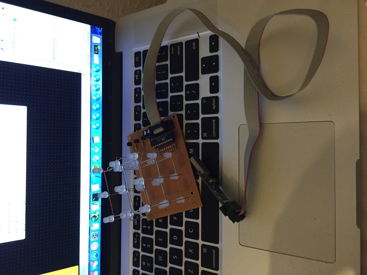

Hey Guys,
I am new to µcontrollers I've just finished my new led cube 3x3x3.
But I have a little problem with the program in c on my mac.
I am using xcode for my play ground and avr-dude to program it with my
usb asp on my mac.
ok so my problem is that I looked for a good design but couldn't find
one for the ATtiny 2313 so I designed my schematics etc on my own...
and due to that reason that program I downloaded is not working. I found
out that i used the same I/O pins like the guy my difference is that I
used npn ( 3904 ) transistors for the layers... now I need to change the
3 I/O pins from sinking to sourcing... I'll include the main.c file for
you guys to look over it I already have an idea and will include it as
you'll see. That is my problem oh and that my aver-dude is new so its
not accepting the old const prog_char... I get this error

    DDRB =  0b11111111;  //  PB0-PB7 = GND                 My idea is to
change PORTB all to 0's to source
    PORTB =  0b11111111;  //
    DDRD =  0b1111000;  //  PD6 = GND PD5-3 = +5v         and here PD6 =
0 to source
    PORTD =  0b1000000;

#4286129
Well.
start with the first error message, which is this one
Compiling C: main.c
avr-gcc -c -mmcu=attiny2313 -I. -gdwarf-2 -DF_CPU=8000000UL -Os -funsigned-char -funsigned-bitfields -fpack-struct -fshort-enums -Wall -Wstrict-prototypes -Wa,-adhlns=./main.lst -std=gnu99 -MMD -MP -MF .dep/main.o.d main.c -o main.o
main.c:1:3: error: expected identifier or '(' before '/' token
**/ Mini-LED-Cube 1.0
The compiler even shows you the line in error
There seems to be something wrong with the comment.
Unfortunately I cannot see this line in the source code you posted. So
make sure you compile the correct code.
Correct that comment in your source code file and compile again. You
will find that lots of errors have gone away. They are just errors,
which are triggered by this erronous comment.
It is not compiling because there are syntax errors.
If your programm works or works not, nobody can say right now, because
it does not even compile.
> That is my problem
Your problem is, that you think programming is something one does not
need to learn BEFORE starting a project like a LED-cube. Start where
everybody else starts: with a single LED on some port pin. Work your way
upwards, including timer handling and in 3 or 4 month you have the
knowledge to programm a LED cube. A cube is not a good project to start
learning, for you need to know and have to have a lot of skills in
programming such a beast. For a beginner it is much to compilcated.
