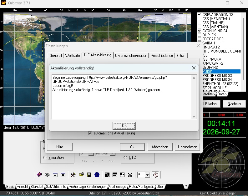

Das von mir benutzte Programm Orbitron 3.71 synchronisiert die TLE-Daten seit einiger Zeit nicht mehr. Das Programm holt beim Öffnen diese Daten automatisch ab. Dazu gibt es eine Liste von Links, die dabei abgeklappert werden.
https://www.celestrak.org/NORAD/elements/stations.txt https://www.celestrak.org/NORAD/elements/amateur.txt https://www.celestrak.org/NORAD/elements/cubesat.txt https://www.celestrak.org/NORAD/elements/dmc.txt https://www.celestrak.org/NORAD/elements/education.txt https://www.celestrak.org/NORAD/elements/engineering.txt https://www.celestrak.org/NORAD/elements/geo.txt https://www.celestrak.org/NORAD/elements/geodetic.txt https://www.celestrak.org/NORAD/elements/globalstar.txt https://www.celestrak.org/NORAD/elements/glo-ops.txt https://www.celestrak.org/NORAD/elements/goes.txt https://www.celestrak.org/NORAD/elements/gorizont.txt https://www.celestrak.org/NORAD/elements/gps-ops.txt https://www.celestrak.org/NORAD/elements/intelsat.txt https://www.celestrak.org/NORAD/elements/iridium.txt https://www.celestrak.org/NORAD/elements/military.txt https://www.celestrak.org/NORAD/elements/molniya.txt https://www.celestrak.org/NORAD/elements/musson.txt https://www.celestrak.org/NORAD/elements/nnss.txt https://www.celestrak.org/NORAD/elements/noaa.txt https://www.celestrak.org/NORAD/elements/orbcomm.txt https://www.celestrak.org/NORAD/elements/other.txt https://www.celestrak.org/NORAD/elements/other-comm.txt https://www.celestrak.org/NORAD/elements/radar.txt https://www.celestrak.org/NORAD/elements/raduga.txt https://www.celestrak.org/NORAD/elements/resource.txt https://www.celestrak.org/NORAD/elements/sarsat.txt https://www.celestrak.org/NORAD/elements/science.txt https://www.celestrak.org/NORAD/elements/tdrss.txt https://www.celestrak.org/NORAD/elements/tle-new.txt https://www.celestrak.org/NORAD/elements/visual.txt https://www.celestrak.org/NORAD/elements/weather.txt https://www.celestrak.org/NORAD/elements/x-comm.txt
Ich vermute, dass das Format oder die Web-Adresse nicht mehr korrekt angegeben ist. Man kann die Keplerdaten zwar händisch von anderen Seiten downloaden und dann kopieren. Es wäre aber schön, wenn das wieder wie früher automatisch funktionieren würde.
Der Programmierer des Programms aktualisiert sein Produkt schon lange nicht mehr. Auf weiteren Internetseiten werden die Daten nur mit Account herausgegeben.
Mich würde eine Bezugsquelle und/oder der genaue Wortlaut des Strings für alle aktuellen Raumstationen (stations.txt) interessieren.

Danke für den Link. Der funktioniert. Vermutlich lag der Fehler beim http ohne s.
Nein, mit deiner unbegründeten Vermutung liegst du sicher falsch. Auch ein "http" (ohne 's' findet deine Daten nicht.
Der Grund ist vielmehr, dass das TLE-Format als Katalognummer maximal 5-stellige Zahlen unterstützt und die aktuelle Anzahl von Objekten diese Grenze inzwischen überschreitet. Die Ausgabe im (alten) TLE-Format funktioniert nicht für Objekte mit Nummern über 99999, d.h. das Format wird jetzt nur noch aus Gründen der Rückwärtskompatibilität als Alternative angeboten. Für neue Objekte wird es folglich wohl auch keine Daten im TLE-Format geben können.
http://www.celestrak.org/NORAD/documentation/gp-data-formats.php
