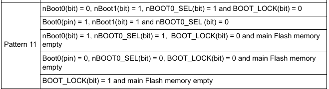

Beim G4 ist es hoffentlich nicht so, weiß ich noch nicht.
Laut AN2606, STM32G07xxx/08xxx device bootloader, gilt Pattern 11, s.o.
und das RM0444 sagt zum G0x1:
3.3.2 FLASH empty check
  During the OBL phase, after loading all options, the Flash memory
  interface checks whether the first location of the Main memory is
  programmed. The result of this check in conjunction with the boot0
  and boot1 information is used to determine where the system has
  to boot from.
3.4.1 FLASH option byte description
Reset value: 0xFFFF FEAA (ST production value)
Bit 26 nBOOT0: nBOOT0 option bit
  0: nBOOT0 = 0
  1: nBOOT0 = 1
Bit 25 nBOOT1: Boot configuration
  Together with the BOOT0 pin or option bit nBOOT0 (depending on
  nBOOT_SEL option bit configuration), this bit selects boot mode
  from the Main Flash memory, SRAM or the System memory.
  Refer to Section 2.5: Boot configuration.
Bit 24 nBOOT_SEL: BOOT0 signal source selection
  This option bit defines the source of the BOOT0 signal.
  0: BOOT0 pin (legacy mode)
22
  1: nBOOT0 option bit
Der Ausdruck "legacy mode" tröstet mich überhaupt nicht :(
