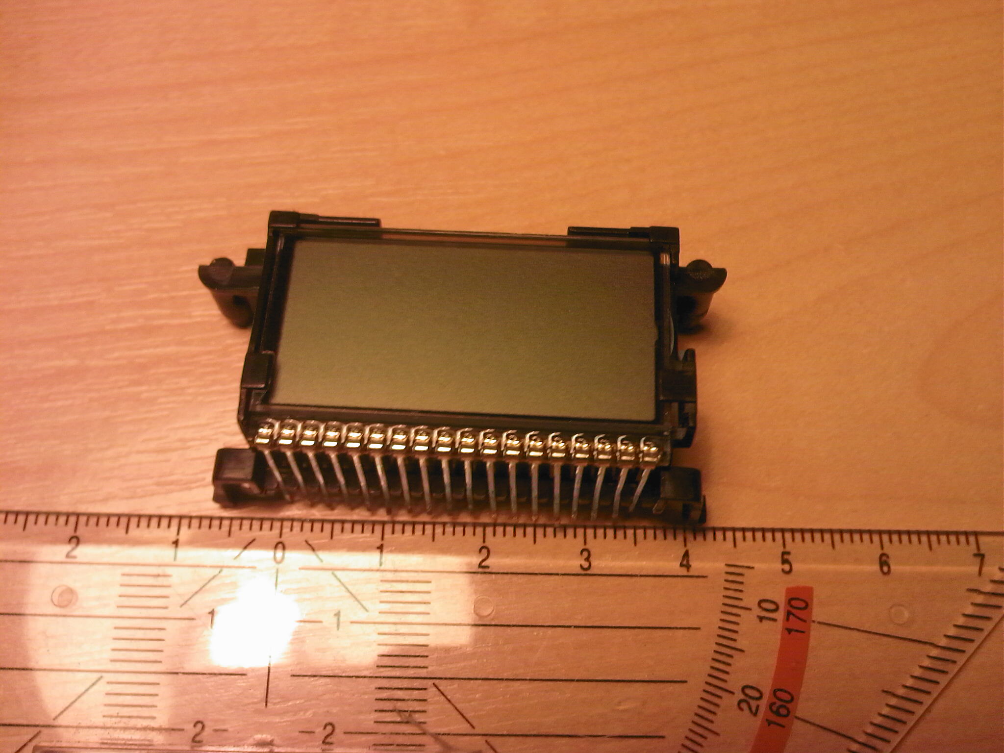

Altes Lcd ohne Datenblatt programmieren - AVR
#1232343
1. http://atmel.com/dyn/resources/prod_documents/doc2569.pdf
(AVR241: Direct driving of LCD display using general I/O  (11 pages,
revision A, updated 04/04)
This application note describes software driving of LCDs with one common
line, using the static driving method.)
2. möglicherweise kann man auch damit was anfangen:
http://www.pollin.de/shop/shop.php?cf=detail.php&pg=OA==&a=NTYwOTk4OTk=&w=ODk4OTk4&ts=0
( ICM7211AM - Treiber-IC für 7-Segment LC-Displays. 4 Digits
ansteuerbar. 44-polig. )
