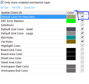

Gast #4669107
Sorry for a response in English, I've just stumbled upon the same issue
and found a solution. The procedure I used to resolve the problem is as
follows:
 - Right-click on PCB space -> Options -> Board Layers & Colors
 - In the System Colors table, make sure Default Colors for New Nets
option is checked, for some reason it gets unchecked sometimes and this
causes the airwires to disappear. This should resolve the issue.
