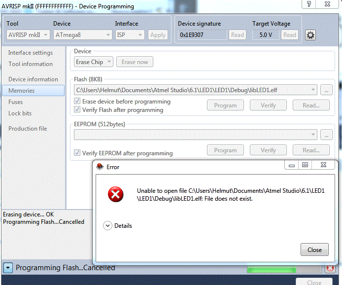

ich habe gerade meinen ersten Versuch mit dem Atmel Studio und einem
ATMEGA8. Beim Versuch zu flashen kommt die Fehlermeldung, dass keine
.elf Datei da ist. Die Datei ist tatsächlich nicht generiert worden.
Kann mir jemand an Hand des log-Files sagen wo ich in der IDE noch etwas
einstellen muss damit eine "flashbare" Datei generiert wird?
Helmut

------ Rebuild All started: Project: LED1, Configuration: Debug AVR
Build started.
Project "LED1.cproj" (ReBuild target(s)):
Target "PreBuildEvent" skipped, due to false condition;
('$(PreBuildEvent)'!='') was evaluated as (''!='').
Target "CoreRebuild" in file "C:\Program Files (x86)\Atmel\Atmel Studio
6.1\Vs\Compiler.targets" from project "C:\Users\Helmut\Documents\Atmel
Studio\6.1\LED1\LED1\LED1.cproj" (target "ReBuild" depends on it):
  Task "RunCompilerTask"
    C:\Program Files (x86)\Atmel\Atmel Studio 6.1\shellUtils\make.exe
clean all
    rm -rf  LED1.o
    rm -rf  LED1.d
    rm -rf "libLED1.elf" "libLED1.a" "libLED1.hex" "libLED1.lss"
"libLED1.eep" "libLED1.map" "libLED1.srec"
    Building file: .././LED1.c
    Invoking: AVR/GNU C Compiler : 3.4.2
    "C:\Program Files (x86)\Atmel\Atmel Toolchain\AVR8
GCC\Native\3.4.2.1002\avr8-gnu-toolchain\bin\avr-gcc.exe"
-funsigned-char -funsigned-bitfields -DDEBUG  -O1 -ffunction-sections
-fdata-sections -fpack-struct -fshort-enums -g2 -Wall -mmcu=atmega8 -c
-std=gnu99 -MD -MP -MF "LED1.d" -MT"LED1.d" -MT"LED1.o"   -o "LED1.o"
".././LED1.c"
    Finished building: .././LED1.c
    Building target: libLED1.a
    Invoking: AVR/GNU Archiver : 3.4.2
GCC\Native\3.4.2.1002\avr8-gnu-toolchain\bin\avr-ar.exe" -r  -o
libLED1.a  LED1.o
GCC\Native\3.4.2.1002\avr8-gnu-toolchain\bin\avr-ar.exe: creating
libLED1.a
    Finished building target: libLED1.a
  Done executing task "RunCompilerTask".
  Task "RunOutputFileVerifyTask"
  Done executing task "RunOutputFileVerifyTask".
Done building target "CoreRebuild" in project "LED1.cproj".
Target "PostBuildEvent" skipped, due to false condition;
('$(PostBuildEvent)' != '') was evaluated as ('' != '').
Target "ReBuild" in file "C:\Program Files (x86)\Atmel\Atmel Studio
6.1\Vs\Avr.common.targets" from project "C:\Users\Helmut\Documents\Atmel
Studio\6.1\LED1\LED1\LED1.cproj" (entry point):
Done building target "ReBuild" in project "LED1.cproj".
Done building project "LED1.cproj".
Build succeeded.
========== Rebuild All: 1 succeeded, 0 failed, 0 skipped ==========
OP #3456775
Hallo Holger,
vielen Dank. Dein Tipp war Gold wert.
Nachdem ich keinen "Knopf" gefunden habe das aktuelle Projekt
umzustellen  habe ich ein neues "normales" Projekt angelegt und es
funktioniert jetzt.
Die zwei LEDs leuchten und blinken.
Jetzt kann es losgehen. :-)
Helmut
