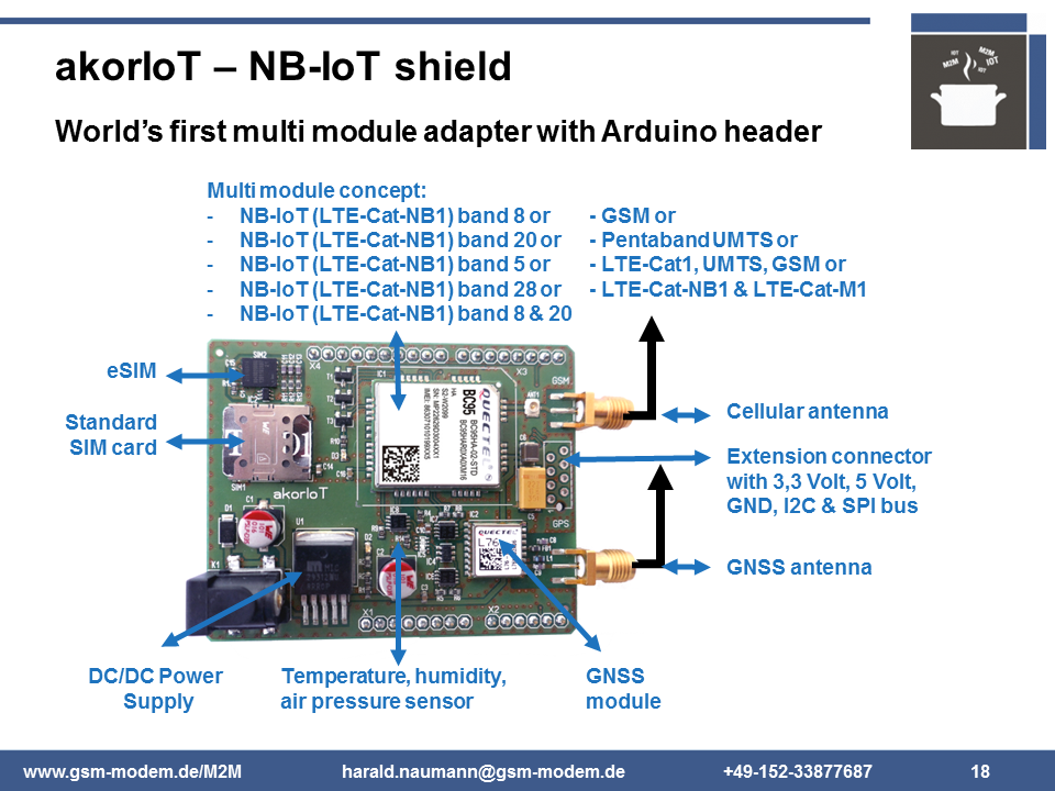

Ich zitiere mal aus dem Quick Start Guide des akorIoT. akoriIoT is ein
Funkadater mit Arduino R3 Header hier:
http://www.gsm-modem.de/M2M/m2m-componets/module-nb-iot-lte-cat-m1-gprs-gps/
"Further code you will write on your own responsibility. The UART for
the cellular module we wired on the same PINs like the origin GSM shield
at Arduino website. Their code will maybe run, but we also detected
mistakes on the code for download at several sources. Free code on the
Internet is just interesting to understand which AT commands were used.
A lot of code examples send an AT command and start a timer to wait and
send the next AT command. This style of coding will work for a quick and
dirty test, but not for IoT devices in mass production. Again, for first
steps and learning the basics an Arduino UNO is fine but for mass
production not. We at akorIoT team use the Arduino UNO to test our radio
adapters and to show that the akorIoT Cx is working. Redesigns for
akorIoT radio adapter to a customised PCB we make most time on some kind
of ARM Cortex M0, M3 or M4 MCU. For that reason, we recommend STM32
Nucleos. Other MCU kits with Arduino header by Microchip, ATMEL, Intel,
Nordic Semiconductor and a lot of more will do the job as well"
"Be aware that you are responsible for your code and your hardware
design. As long you stay with the Arduino UNO you have the freedom to
ask the Arduino community, but you cannot expect to get always the right
answer free of charge. Commercial operating engineering office can not
offer free of charge answers. The hobbyists will maybe do it and help
with free code samples including the free of charge software bugs. If
your application is a commercial application with a budget for
development, then you have the option to ask for HW and SW support with
the akorIoT team. The support is from checking the schematic diagrams,
PCB layout, antenna"
