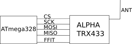

For the connection between the uC and the modules see attachment
"circuitry.png".

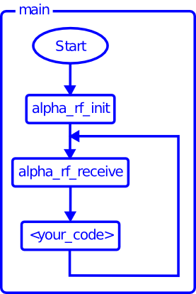

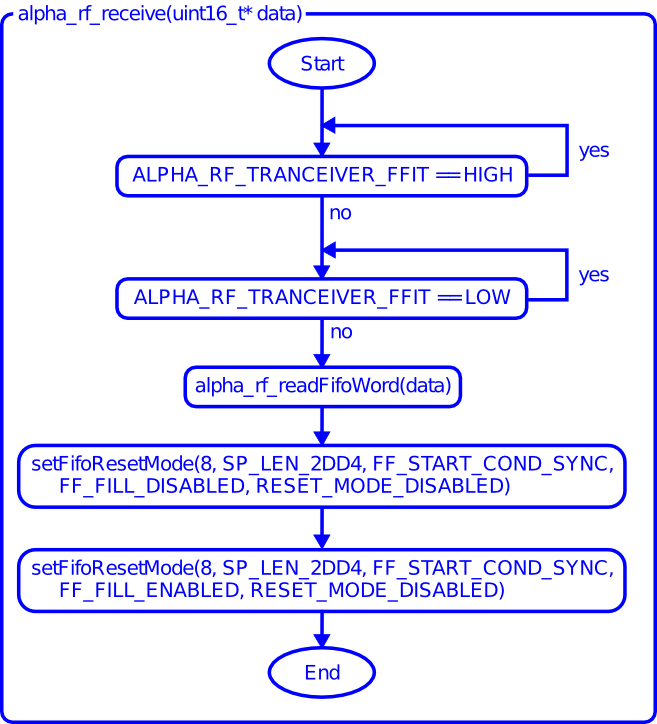

The main loop comprises the receiving routine. The receiving is
initiated by the FFIT line. Every time the module receives data it
generates an IRQ on the FFIT line. This kept my uC very busy even when I
did not want to receive something. Therefore I designed a state machine
which either receives data or processes them. In case you have parallel
execution nothing objects against an IRQ handler with the receiving
routine and parallel data processing in the main loop. For simplicity
reasons I use the state machine. The main routine is shown in image
"main.png".

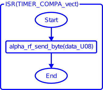

For successful reception of data a periodic data transmission is
required. Therefore the transmission is done with a timer IRQ handler as
shown in "TIMER_COMPA_vect.png". With the timer settings the actual data
transmission rate is adjusted. The settings used above are valid for
calling the timer handler with 20 Hz.

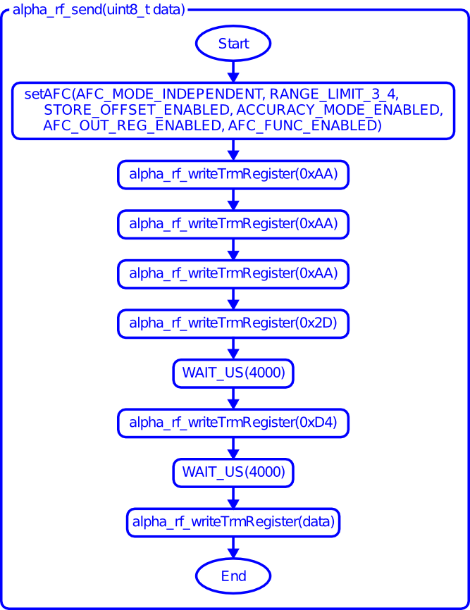

Image "alpha_rf_send.png" shows the transmission routine which is
straight forward. The WAIT_US(4000) depends on initialisation settings,
I suppose. I had to work it out by trial and error.
