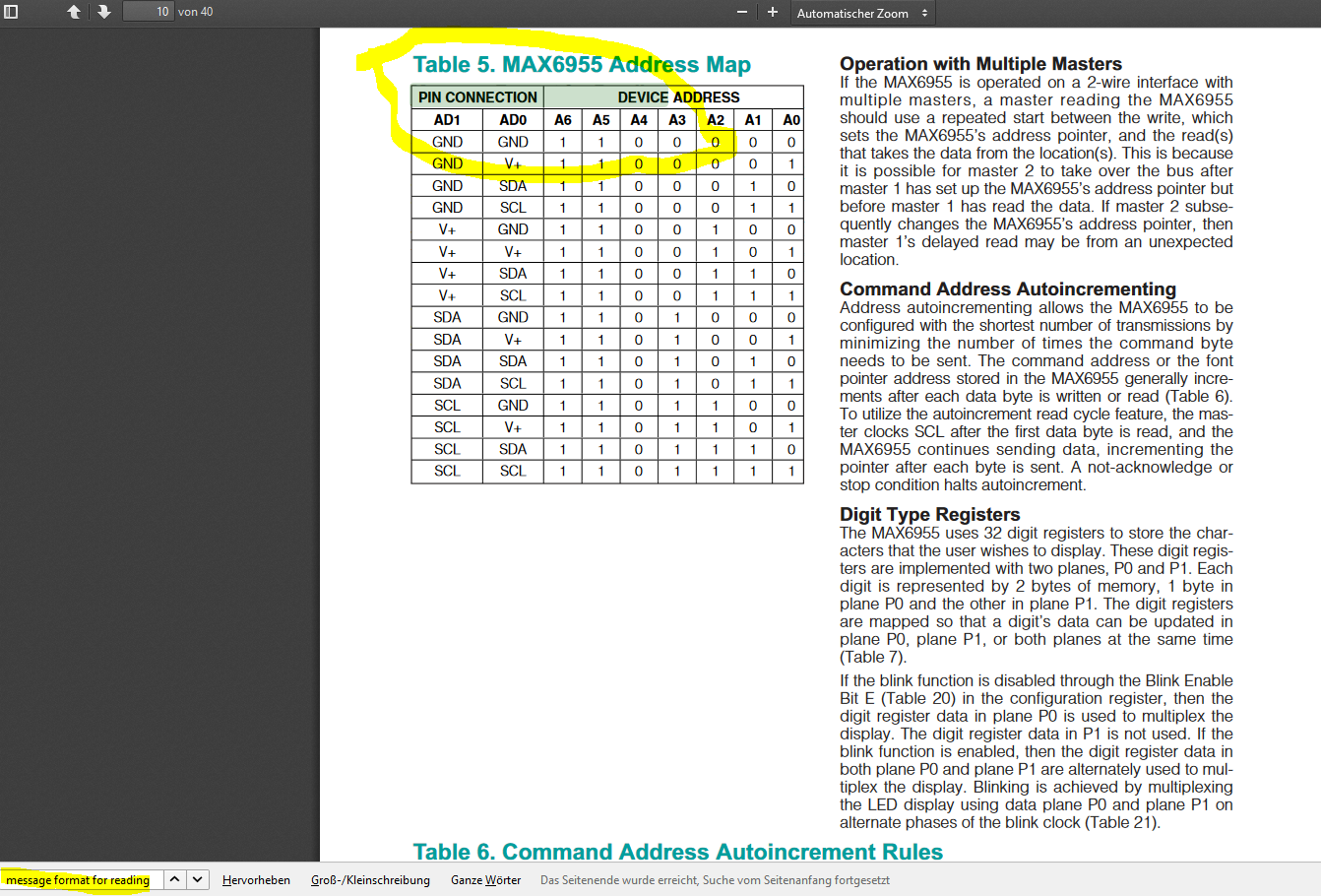

Da ist wohl im Datenblatt was verrutscht. Wenn man nach "message for reading" sucht, landet man sozusagen unter Table5.
Der Abschnitt zum Auslesen von Registern befindet sich hinter der Tabelle. Die Tabelle ist zu weit oben
Der verlorene Abschnitt Message Format for Reading ********************************* The MAX6955 is read using the MAX6955’s internally stored command byte as address pointer, the same way the stored command byte is used as address pointer for a write. The pointer generally autoincrements after each data byte is read using the same rules as for a write (Table 6). Thus, a read is initiated by first configuring the MAX6955’s command byte by performing a write (Figure 7). The master can now read n consecutive bytes from the MAX6955, with the first data byte being read from the register addressed by the initialized command byte (Figure 9). When performing readafter-write verification, reset the command byte’s address because the stored byte address generally is autoincremented after the write (Table 6). ************************************************************************ * https://web.archive.org/web/20121224060106/https://datasheets.maximintegrated.com/en/ds/MAX6955.pdf
