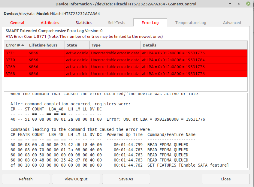

Kann mir vielleicht irgendjemand erklären, wo das Problem mit dieser
Festplatte ist?
Complete error log:

Error 8771 [2] occurred at disk power-on lifetime: 6866 hours (286 days + 2 hours)
  When the command that caused the error occurred, the device was active or idle.
22
23
  After command completion occurred, registers were:
24
  ER -- ST COUNT  LBA_48  LH LM LL DV DC
25
26
  40 -- 51 00 08 00 00 01 2a 08 00 01 00  Error: UNC at LBA = 0x012a0800 = 19531776

von Simonetta (Gast)
Hier noch eine andere Fehlermeldung:
mint@mint:~$ sudo mount /dev/sda3 /windows/
ntfs_attr_pread_i: ntfs_pread failed: Input/output error
Failed to read of MFT, mft=6 count=1 br=-1: Input/output error
Failed to open inode FILE_Bitmap: Input/output error
Failed to mount '/dev/sda3': Input/output error
NTFS is either inconsistent, or there is a hardware fault, or it's a
SoftRAID/FakeRAID hardware. In the first case run chkdsk /f on Windows
then reboot into Windows twice. The usage of the /f parameter is very
important! If the device is a SoftRAID/FakeRAID then first activate
it and mount a different device under the /dev/mapper/ directory, (e.g.
/dev/mapper/nvidia_eahaabcc1). Please see the 'dmraid' documentation
for more details.
von Peter M. (r2d3)
Hallo Simon,
zeig' mal die SMART-Parameter Deiner Festplatte.
