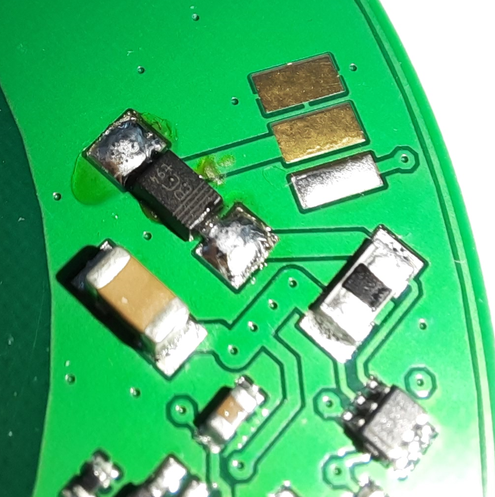

Diode gesucht, Marking "BC T94"
Vermutlich
BC    BZT52H-C5V6  Philips  SOD123F  Z-diode 5.2..6.0V, Izt=5mA,
Zzt=40?, 375mW
https://assets.nexperia.com/documents/data-sheet/BZT52H_SER.pdf
aber auch
BC    MMSZ4678  EIC  SOD123  Z-diode 1.8±5%, Izt=50µA, 500mW
https://www.alldatasheet.com/datasheet-pdf/pdf/151049/EIC/MMSZ10.html
BC    1KE3F08C  Kexin  SOD323  ESD Protection Diodes
http://www.kexin.com.c n/pdf/1KE3F%20Series.PDF
BC    BZX399C5V6  Philips  SOD323=SC76  Z-diode 5.6V±5%, 300mW
https://www.mikrocontroller.net/attachment/11446/BZX399.pdf
BC    GBLC08CI  Protek, ShanghaiSemitech  SOD323=SC76  TVS 8V, 2A,
350W(1ms), 0.6pF, Bidirectional
http://www.protekdevices.com/xyz/documents/datasheets/gblci.pdf
BC    GBLC08CI  Smiths  SOD323=SC76  1-Line Low Capacitance
Bi-directional TVS Diode
http://1510832172.guonei.facecloud.net/filedownload/109295
BC    UDZ5V6B  Diodes  SOD323=SC76  Z-diode 5,6V±2,5%, 200mW
https://html.alldatasheet.com/html-pdf/59362/DIODES/UDZ18B/365/2/UDZ18B.html
BC    ZMS2811  Zetex  SOD323=SC76  Si-diode Schottky Rectifier, 15V, 1A,
250mW, Vf<410mV(1mA)
