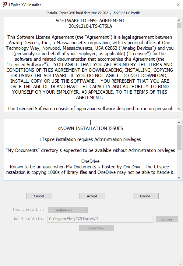

Mit der Version vom 22. März 2021 poppt bei der Installation von LTspice
neben den Lizenzvereinbarungen auch ein Hinweist auf die "KNOWN
INSTALLATION ISSUES":
KNOWN INSTALLATION ISSUES
LTspice installation requires Administration privileges
"My Documents" directory s expected to be available without Administration privileges
OneDrive
Known to be an issue when My Documents is hosted by OneDrive. The LTspice installation is copying 1000s of library files and OneDrive may not be able to handle it.
VMware Workstation
When My Documents is in a shared folder via VMware Workstation, the LTspice installation can be impacted as it is trying to copy 1000s of library files.
UPDATES
When running WebSync to get the most updated application and libraries also requires Administration privileges
Zumindest bei mir klappt die Synchronisation über OneDrive.
