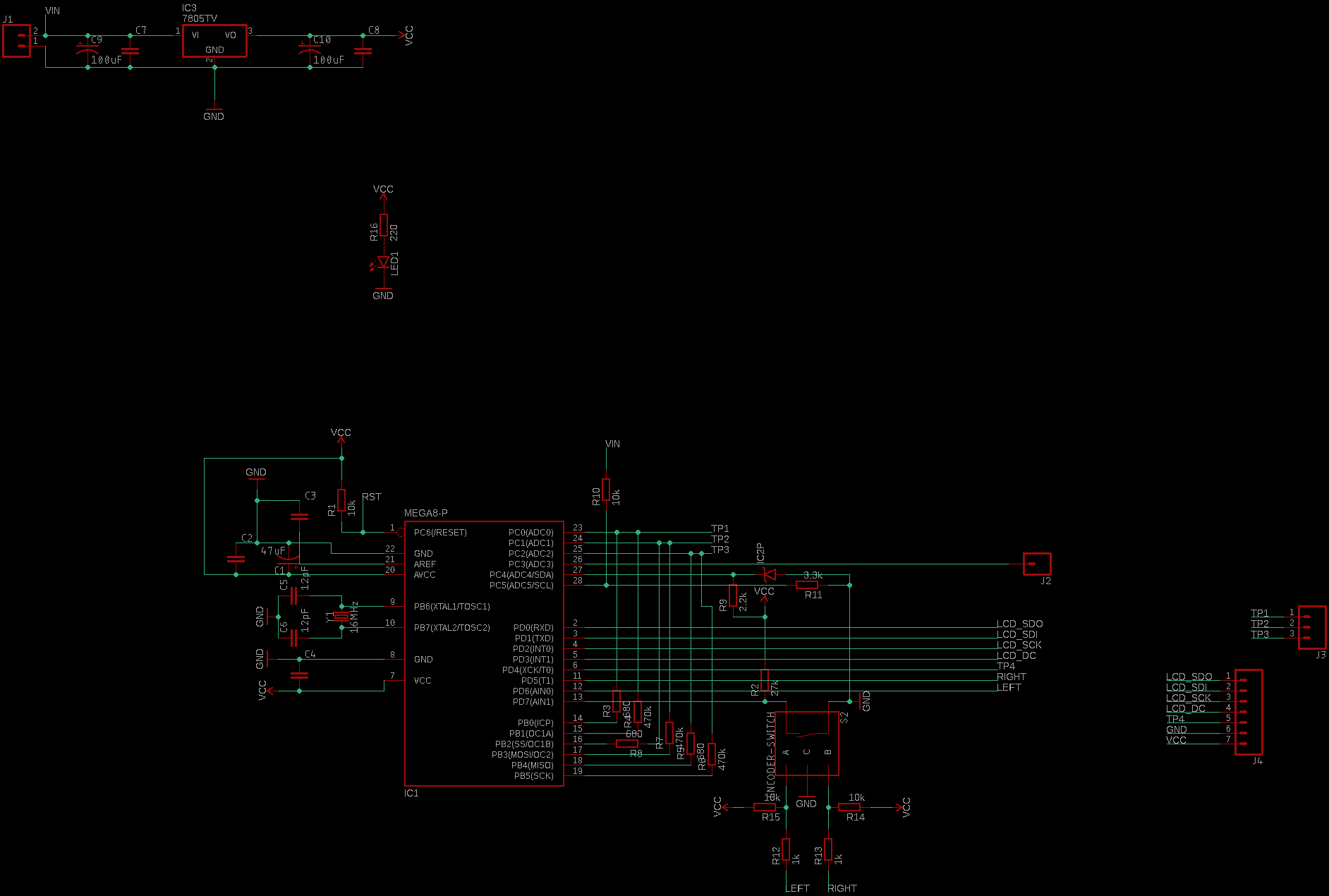

Hi forum!Is my first post on this forum and I have a small problem whit
ComponentTester-1.42m.
I was able to build my own pcb (schema in attachment), do some changes
as encoder is connect to PD5 PD6.
I spot two issue:
I'm  not able to compile correctly hex where i have fallowing options
selected:
* #define HW_ENCODER @ config.h
* set lcd to use ILI9342
 result of compilation is:
AVR Memory Usage
Device: atmega328
Program:   34746 bytes (106.0% Full)
(.text + .data + .bootloader)
Data:        254 bytes (12.4% Full)
(.data + .bss + .noinit)
EEPROM:      773 bytes (75.5% Full)
(.eeprom)
Second issue is a problem whit PCD8544:
what ever I do and change on config_328.h is no difference no signal on
nokia display (display check and is working fine). already check PD0 PD1
PD2 PD3 PD4 on logic analyzer and is flat line no signal at all.
PCB check and is fine as long i don't miss anything on schema.
Flew different Atmega used including 328p (all atmega working fine but
not as CompopnentTester).
I attach my config.h and config_328.h please help me to sort this
problem.
I don't mind stay whit PCD8544 against ILI but i need working device.
Thanks in advice
