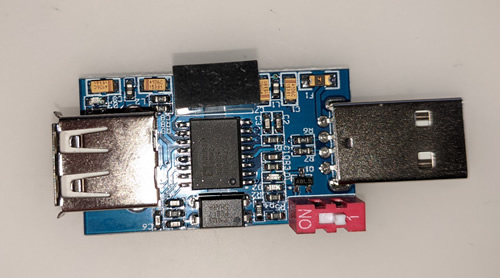

USB-Isolator - DIP-Schalter?
#6640142
Das Original von AD hat mehrere Jumper:
https://www.analog.com/media/en/technical-documentation/user-guides/EVAL-ADuM4160EBZ-UG-043.pdf
Bei Amazon gibt es diese Bezeichnung
"iHaospace 1500V USB to USB Isolator Board Protection Isolation ADUM4160
ADUM3160 Voltage Isolator Module Support 12Mbps 1.5Mbps "
https://www.amazon.de/iHaospace-Isolator-Protection-Isolation-ADUM4160/dp/B07F1RW4FY
Gast #6640145
"The switch like it is in the pictures selects the isolator to operate
at full speed data rate of 12 MBps. If low speed is needed, the DIP
switch should be moved to “ON” position."
