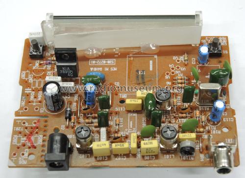

Hi there, when hunting for Condrad RDS Manager (which is on its way now,
thanks to a forum user, read here for more details:
Beitrag "Re: Condrad RDS Manager (anyone has?)"
I came across 3 different versions
1: version in box (box-version.jpg, better picture here:
Beitrag "Schaltplan CONRAD RDS Manager gesucht"

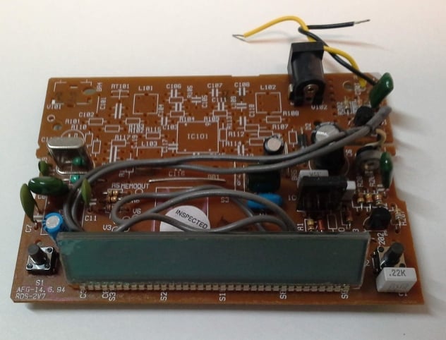

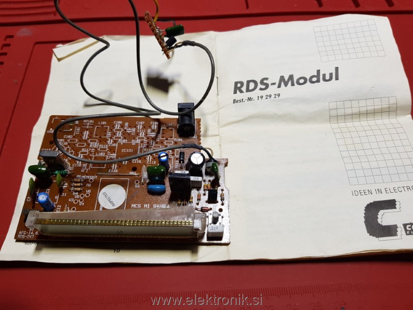

2: built-in version that has LCD backlight (light.jpg)
3: built-in version that has no LCD backlight (no_light.jpg
now apart from obvious diferences like a missing RCA jack, no light bulb
the built-in version is a bit different as well (the box version does
not have the left portion (where X is on box-version.jpg picture and it
looks like you can just break that section off (it has dots)) populated
while both of the bult-in versions have that populated
and the box version also has a lot of components that built-in version
does not have (my software engeneering eyes only spotted the most
obvious ones, like the RCA jack :) (but I was then confused as I didn't
understand why the built-in version has a wire going to the section that
you can break off, while the boxed version does not have that) but after
some help from my friends and after reading this:
Beitrag "Schaltplan CONRAD RDS Manager gesucht" I think that there is some
filter section missing, now I woud like to hook this into a stereo
output of a reciever /when reciever is in MONO of course) (it has
de-emphasis so RDS will be realy weak after that so I think I need this
missing components that the box version has which mine does not)
sorry for the wierd questions I think that here:
https://www-mikrocontroller-net.translate.goog/topic/320162?_x_tr_sl=auto&_x_tr_tl=en&_x_tr_hl=sl
its written what is missing but I am realy confused as I have no idea
what to buy and after that where on the device I have to solder all this
to make my built-in version the box version
Thanks for Anwsering and Best Regards
