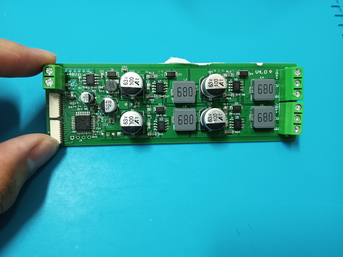

von Michael L. (Firma: Ling'an Technology of China) (michael_l697)
I always use these LED driver chips such as PT4115 to drive the
high-power LEDs with PWM Dimming. One chip can drive Max. 45W LEDs (48V
1A).
You can refer to my circuit diagram. MCU reads the signal of the touch
chip, and then adjusts the light in PWM mode.
If you need these driver chips, tell me the parameters (how many LEDs
are in series and parallel), and I can send them to you.
