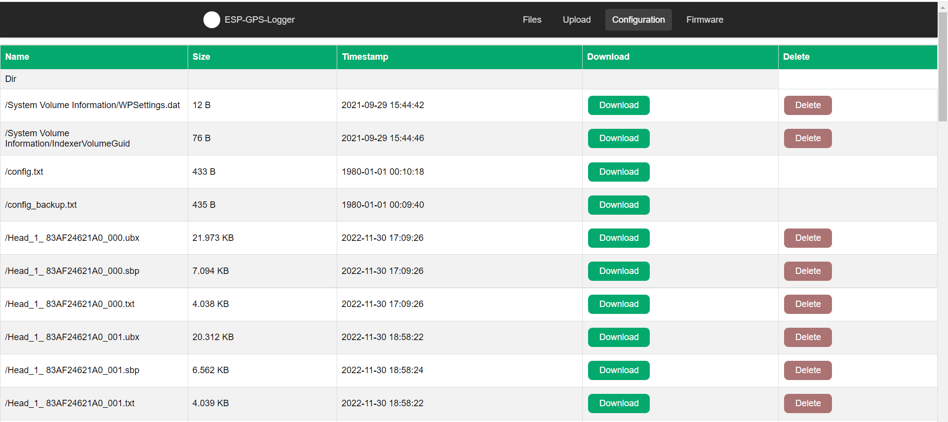

#7444395
Hier mein ESP-gps logger project : https://github.com/RP6conrad/ESP-GPS-Logger/blob/master/README.md Nicht mehr so basic, mit naechste Funtionen : SD card fur logging Wifi SSID / AP (AP für erse mal Wifi credentials) OTA Webserver (configuration + downloading/uploading files) FTP (downloading / uploading files) gps logging ubx protocoll E-paper display
