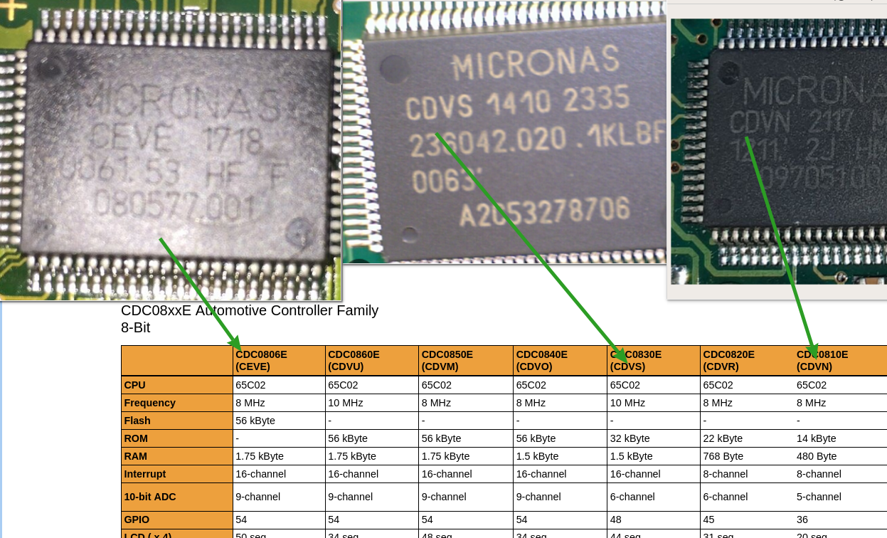

Hello everyone,
this is my first time here so please have mercy on me.
I have two (What I guess) Mikrocontrollers and I can not figure out what exactly are:
Mikrocontroller 1 with 80 PIN (Printed Information):
-------------| IM | CEWE E808 | 9167 51 WF F |
072432000
Mikrocontroller 2 with 100 PIN(Printed Information):
-------------| IM | CEWE E740 | 9161 51 WF F |
072155001
Could someone please explain me what are these two and where can I find Datasheet for them.
Kind Regards Michael

No guarantees for anything, info may apply to your devices, or not. And I often just glance over the contents
Michael B. schrieb:
what are these two
Well I found an IC with "ceve", see attached image. Second line "0061 53 HF F", same structure as yours, last line same number of digits
Micronas seems to have marked their automotive microcontrollers with "ceve",cdvn,cdvs ect. In the attached image you can see the corresponding data in the chart.
Here the source in Wayback, dated 2003, not much data on that page however
https://web.archive.org/web/20030212091925/http://www.micronas.com/products/overview/automotive/index.php
Image sources
https://www.eevblog.com/forum/repair/can-someone-help-me-identify-this-chip/ Beitrag "Prozessor Information (Datasheet)" https://forums.lr4x4.com/topic/106418-td5-instrument-retrofit-fuel-shows-max-faulty-speedo-fix/

In case info still welcome/needed
Micronas acquired(ect.) ITT Semiconductors in 1997
Michael B. schrieb:
IM | CEWE E740 |
So perhaps you mean "ITT Ceve E740"(?)
Here somebody writes "ITT CEVE 740E" (VW Golf 4 thread)
https://vwts.ru/forum/topic/128237/post-1721180
So considering ITT Semiconductors was acquired by Micronas, this chart from previous post may still apply https://www.mikrocontroller.net/attachment/624020/screenshot_micronas_CDC08x.png
Here just as a visual example(!) an image of different mcu, an "ITT CVDS E440" https://vwts.ru/images/repair4/157053_09.jpg
