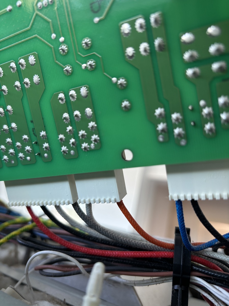

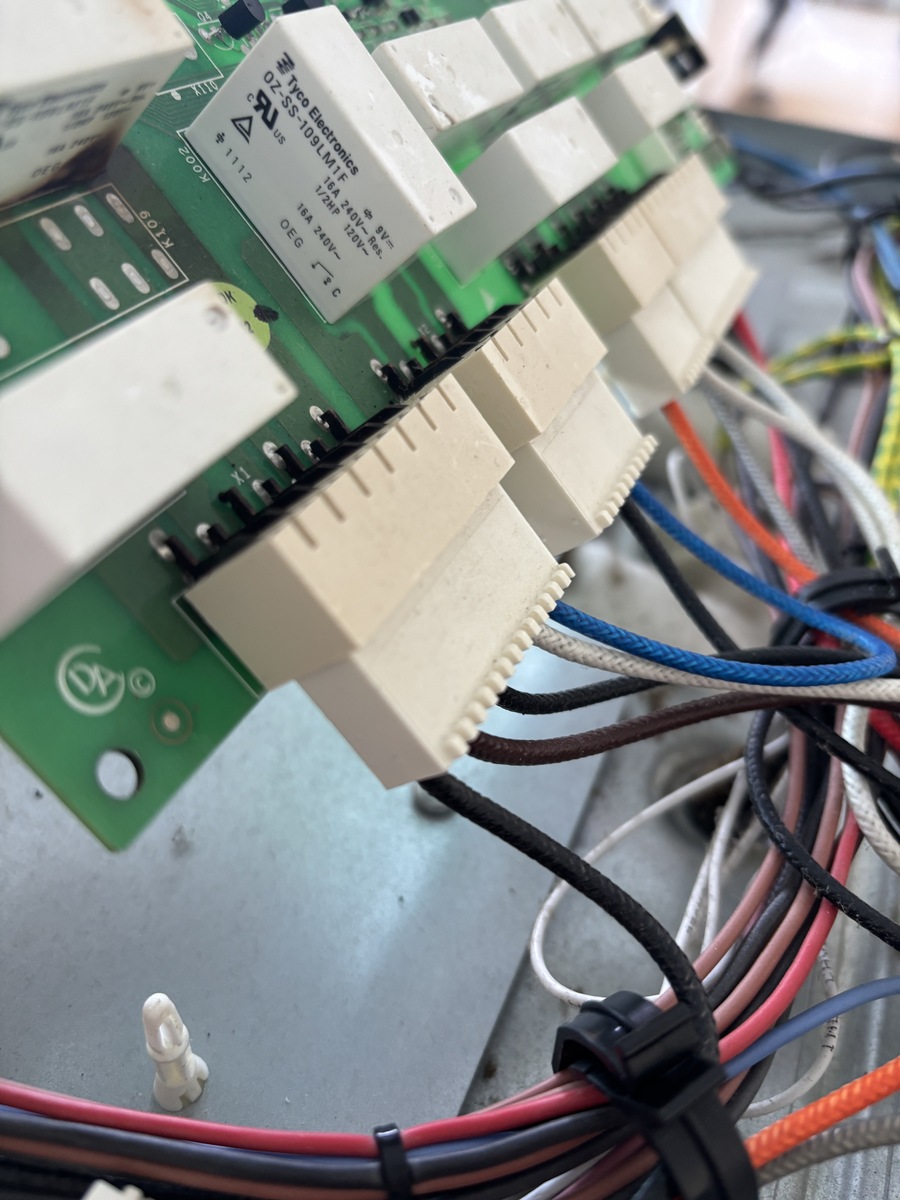

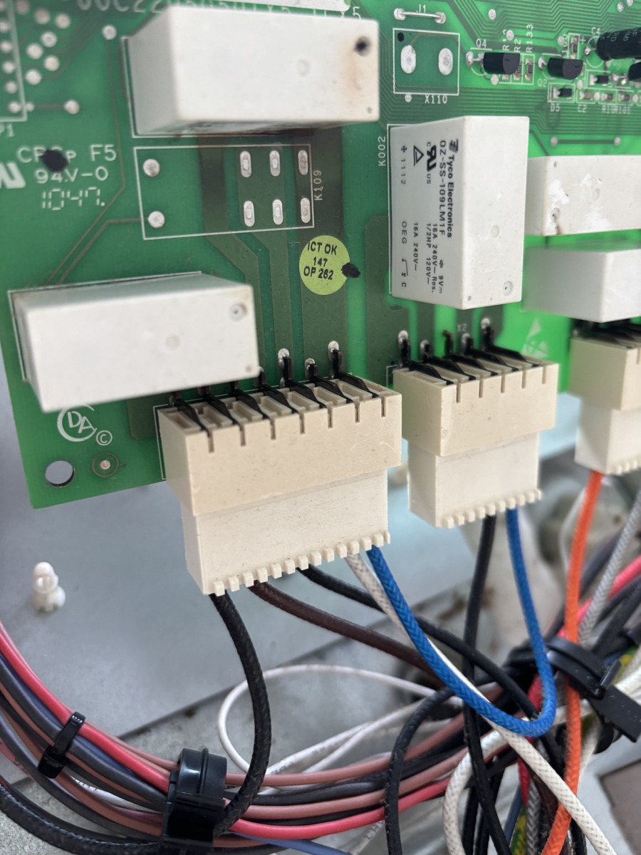

I would like to expand the power module 00663493 of my Gaggenau BO251111/11. Three large multi-pole connectors cannot be released. In the photos you can see a beige part soldered on the circuit board and a white part with the cables. Only the white cable plug needs to be pulled out of the beige PCB plug? Is there a lock that needs to be released first? I don't want to pull harder until I'm sure how to unlock the connector. Device is completely disconnected from the mains. Photos attached.

Looks like multipole 6.3mm blade connectors to me. These are hard to pull when single, a block of them may be close to impossible, especially after sitting tight for 15+ years. But it seems there's no lock so i'd say force is the only way. I'd try adding some force spreader between the edge of the beige and the castellations on the white part and pry it open, preferably starting with the two pole, in case something breaks, it'll be easier to repair two poles instead of 5.
