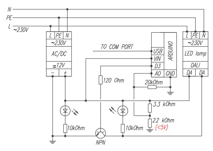

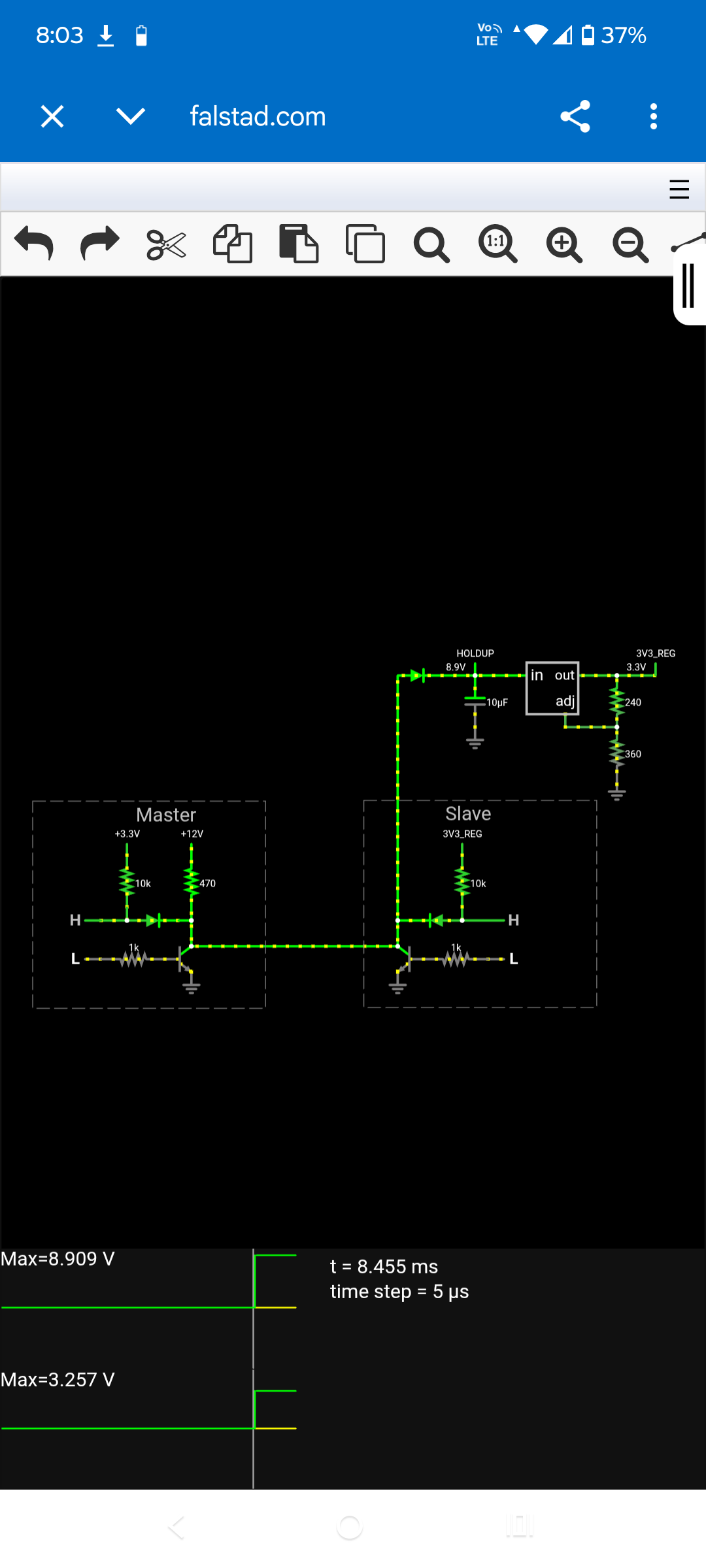

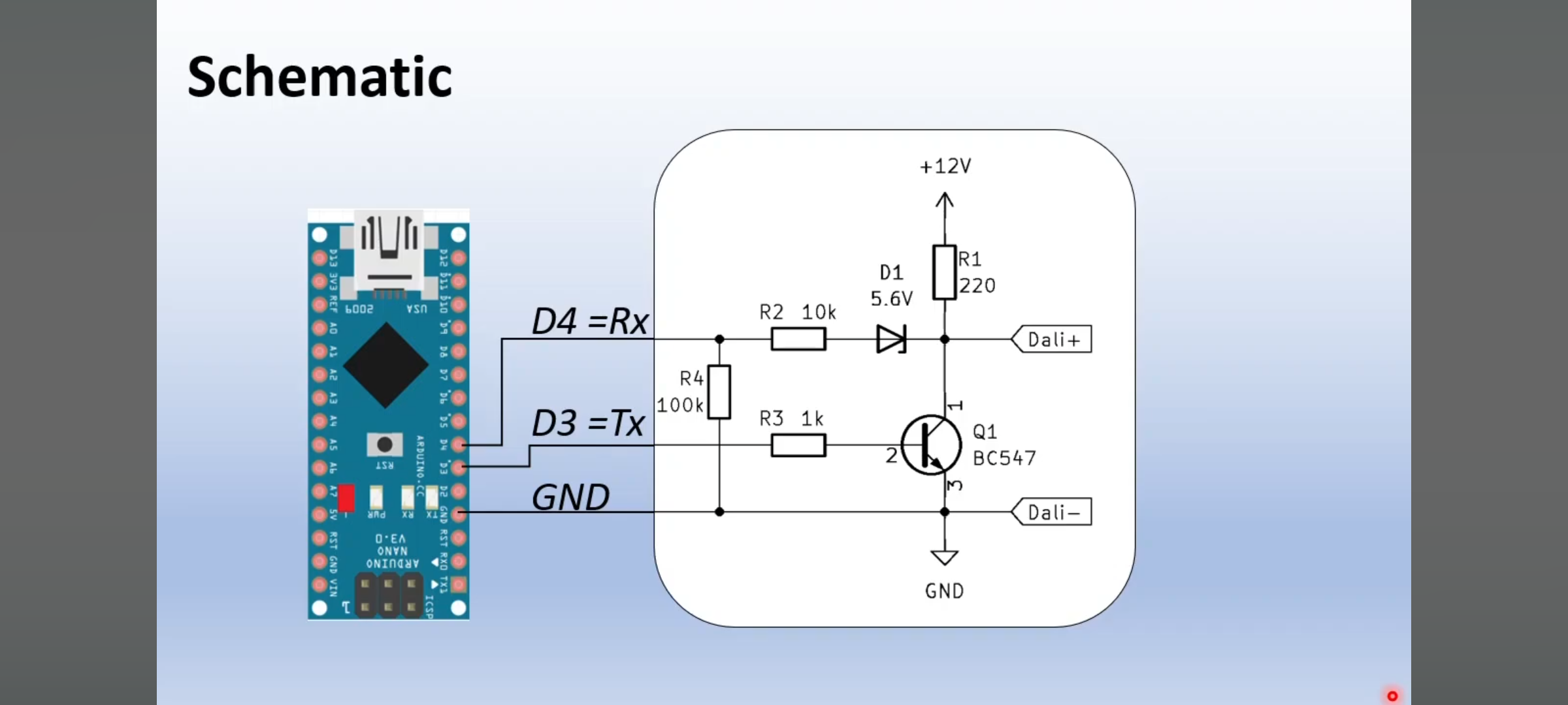

Hi everyone,
I'm trying to get two Arduino Uno boards talking over just two wires, a bit like M-Bus but at a lower voltage. I don't want any extra ICs, only the two Unos plus basic parts like resistors, capacitors, diodes and transistors.
The idea:
  • Master to slave: the master switches the bus between 9V and 7V to send data.
  • Slave to master: the slave replies by pulling extra current (about 45 mA idle, 50-75 mA for a "0"), and the master reads it with a small sense resistor.
  • The slave gets its power from the bus.
A few questions:
  1. Are there simple discrete circuits for this, for both the master and the slave side?
  2. Is a 2V swing enough to read reliably with the Uno's ADC, or should I go bigger?
  3. Is a series sense resistor the best way to read the slave's current pulses?
  4. Could this work over 50 m of cable between the boards? Any tips on cable, baud rate or protect
Thanks a lot for any advice or links!
OP #8104266
Does this approach work. Instead LED microcontroller will be there also Dali uses external powered lights with bus power too so capacitor charging from data doesn't applicable, I believe.
