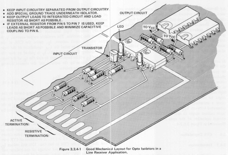

#5450036
Mertens schrieb:
> Gehe ich richtig in der Annahme, dass unter dem Optokoppler keine der
> insgesamt 4 Planes liegen sollte?
Normalerweise wird das so gemacht.
Aber wenn dir Störunempfindlichkeit wichtiger als Isolierung ist,
empfiehlt HP eine Masseleitung unter dem Chip:
> 3.3.4 Layout Considerations for Optically Coupled Isolators
> Optically coupled isolators have excellent common mode
> rejection characteristics. However, for optimum common
> mode rejection, special considerations should be given to
> the circuit layout. Stray capacitance between the input
> circuit and the output circuit should be minimized. This
> can be done by physically separating all input and output
> circuitry on the circuit board. For line receiver applications,
> the shielded cable should also be dressed properly to
> minimize stray capacitance. Since the base of the output
> transistor is especially susceptible to common mode
> transients, a special ground trace under the isolator can
> serve as a shield. To further minimize capacitive coupling
> into the base, pin 7 can be clipped off at the side of the
> package. A simpler approach in an application requiring
> more than one isolator is to use dual packages, because the
> base is unconnected.
