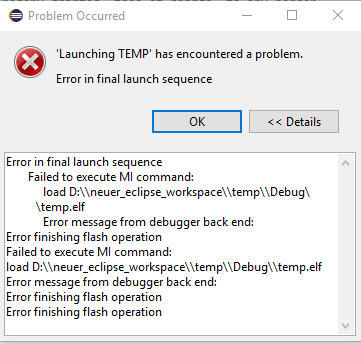

Es kamen folgende Fehlermeldungen:
Error in final launch sequence
Failed to execute MI command:
load D:\\neuer_eclipse_workspace\\temp\\Debug\\temp.elf
Error message from debugger back end:
Error finishing flash operation

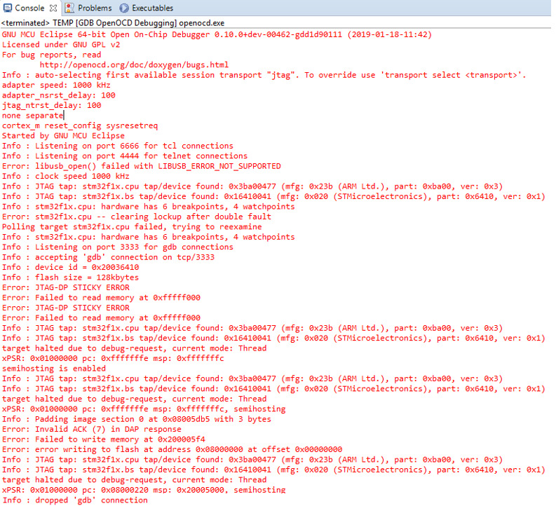

GNU MCU Eclipse 64-bit Open On-Chip Debugger 0.10.0+dev-00462-gdd1d90111
(2019-01-18-11:42)
Licensed under GNU GPL v2
For bug reports, read
  http://openocd.org/doc/doxygen/bugs.html
Info : auto-selecting first available session transport "jtag". To
override use 'transport select <transport>'.
adapter speed: 1000 kHz
adapter_nsrst_delay: 100
jtag_ntrst_delay: 100
none separate
cortex_m reset_config sysresetreq
Started by GNU MCU Eclipse
Info : Listening on port 6666 for tcl connections
Info : Listening on port 4444 for telnet connections
Error: libusb_open() failed with LIBUSB_ERROR_NOT_SUPPORTED
Info : clock speed 1000 kHz
Info : JTAG tap: stm32f1x.cpu tap/device found: 0x3ba00477 (mfg: 0x23b
(ARM Ltd.), part: 0xba00, ver: 0x3)
Info : JTAG tap: stm32f1x.bs tap/device found: 0x16410041 (mfg: 0x020
(STMicroelectronics), part: 0x6410, ver: 0x1)
Info : stm32f1x.cpu: hardware has 6 breakpoints, 4 watchpoints
Error: stm32f1x.cpu -- clearing lockup after double fault
Polling target stm32f1x.cpu failed, trying to reexamine
Info : Listening on port 3333 for gdb connections
Info : accepting 'gdb' connection on tcp/3333
Info : device id = 0x20036410
Info : flash size = 128kbytes
Error: JTAG-DP STICKY ERROR
Error: Failed to read memory at 0xfffff000
target halted due to debug-request, current mode: Thread
xPSR: 0x01000000 pc: 0xfffffffe msp: 0xfffffffc
semihosting is enabled
xPSR: 0x01000000 pc: 0xfffffffe msp: 0xfffffffc, semihosting
Info : Padding image section 0 at 0x08005db5 with 3 bytes
Error: Invalid ACK (7) in DAP response
Error: Failed to write memory at 0x200005f4
Error: error writing to flash at address 0x08000000 at offset 0x00000000
xPSR: 0x01000000 pc: 0x08000220 msp: 0x20005000, semihosting
Info : dropped 'gdb' connection

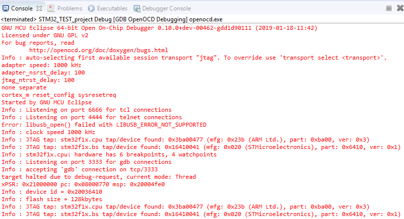

Danke Christopher für deine schnelle Antwort.
Im Anhang haben wir noch die Konsolenausgabe beigefügt, als alles noch
funktioniert hatte.
Da hatten wir auch schon den Fehler
Neu dazugekommen sind (z.B.):
Ich tippe mal, dass ihr die JTAG-Pins des F103 umkonfiguriert habt und
somit, während das Programm läuft nicht mehr per JTAG auf die Hardware
kommt. Lösung des Problems ist ein "connect under reset". Eventuell kann
man da bei GnuMcuEclipse irgendwo ein Häkchen setzen. Ansonsten einfach
den Resetbutton gedrückt halten, Flashvorgang starten und dann, wenn die
Stelle mit dem JTAG-DP STICKY ERROR erscheinen würde, loslassen.
PS: Man kann auch die Bootpins so umjumpern, dass er in den
UART-Bootloader startet. Da hat man dann die JTAG-Pins wieder verfügbar
und man kann das Programm ganz normal per JTAG flashen.
