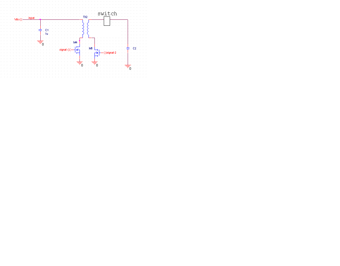

I have a flyback configuration as a part of a more complicated low power
design.
in this design I must disconnect the secondary winding from output
capacitor using a switch or a device funktioning as a switch.
Since this switch must be placed between the secondary winding(which has
floating voltage levels)and output capacitor(which is being charged and
has no constant voltage), both sides of the switch have floating
potentials, therefore there is no reference potential to activate the
switch.
       Requirements:
                    1: an absolute disconnection must exist(no leakage
current)
                    2: Maximum current flowing through this switch is
about 1A
                    3: reverse voltage on the switch(off status) about
900V (difference of the voltage on the
                           output capacitor and the secondary winding)
                    4: switch power dissipation must be very low
                    5: switch must be very fast, some micro seconds
                    6: rise and fall time for the switch turn on and off
must be in nano second
Important: -MOS transistors are not adequate because current leakage
through free wheeling diode
            makes the absolute disconnection impossible!
           -Relays are too slow and bulky
I do appreciate your idea!
I'll be gratefull if any body can help me with this problem!

Gast #1678793
In my design I try to charge and discharge a capacitive load,
demonstrated as output capacitor.
Primary is connected to a low power supply and output capacitor should
be charged to a high voltage level. I switch the primary (low side) in
order to charge the capacitor and I switch the high side(secondary) to
discharge the capacitor.
So the diode in the secondary(used to charge the capacitor) is realized
by the free wheeling diode of the switch in the secondary side(as
depicted in photo) and the diode in primary(used during discharging of
capacitor) is realized by the free wheeling diode of the switch in the
primary side.
Circuit is depicted in the following address.
http://www.4shared.com/photo/ElAXGiDe/question_pic.html
thanx a lot!

Gast #1680282
eProfi schrieb:
> many IGBTs do not have an intrinsic diode.
do these IGBTs fulfil my riquirements listed above(Current,Voltage,...)?
may you please name a few? I could not recognize from the data sheet
whether they are with or without an intrinsic diod.
thanx in advance
Gast #1680362
It should be visible in the diagram and in the text.
There are only a few manufacturers: IXYS and IR , to name a few.
You select the core with the correct air-gap, look to the datasheet for
the Al-value and calculate the L.
Siemens has a broad palette of "sifferit" magnetics:
Here is a collection of their products of year 2000:
www.dextermag.com/uploadedFiles/Literature_Ferrite_EPCOS.pdf  (4 MB)
Read the slup124.pdf ... slup129.pdf of TexasInstruments.
