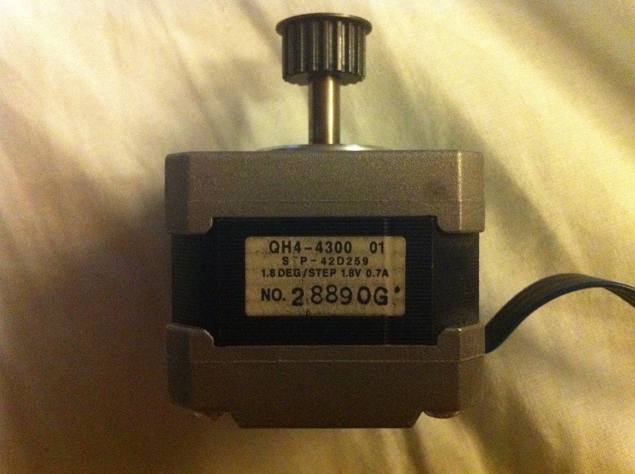

ihr könnt mir helfen, um den datasheet und die Fabrik von diesem Motor
wiederzuerkennen, was seht ihr in Foto Anlage?
ich würde gern nur diesen Motor QH4-4300-01 mit einem driver Controller

The motor looks like salvaged from a scanner or printer or so.
With a multimeter you can easily measure the inner circuit and whether a
bipolar or unipolar driver is needed.

Uhh, what? This is a stepper motor. All the data you need is printed
right on the label! Since it has 4 wires it's bipolar and you need two
H-bridges to drive it.

If you would have taken a closer look on the sticker on the motor, you
should have seen hat the maximum average current per coil is 700mA. The
voltage of a DC source is 1.8V then. The resistance of one coil should
be near 2.5Ω.
Four wires...seems like a bipolar motor to me.
As I said before, a multimeter or continuity buzzer can easily point out
which wire goes where.

von marco s. (work-it)
hallo Malignes Melanom.
Yes.. the homework assignment, has to turn to walk before and back and
to regulate the speed. you can give me you the datasheet volt power of
this motor, capico alone angle deg 1.8 of steep, 1,8v and 0.7A. which
driver controller do I have to purchase or to build?
hi STK500-Besitzer..
respectively 1 = grey, 2 = grey, 3 = grey, 4 = blue.
now, cable 4 with cable 3 are open. cable 4 with cable 2 are close.
cable 4 with cable 1 are open. cable 1 with cable 2 are open. cable 2
with cable 3 are open. cable 1 with cable 3 are close. the ohmeter not
to give any measurement of impedance, but only open or closed.

von Achim M. (minifloat)
Found one coil!
Congrats, you found the other one!
