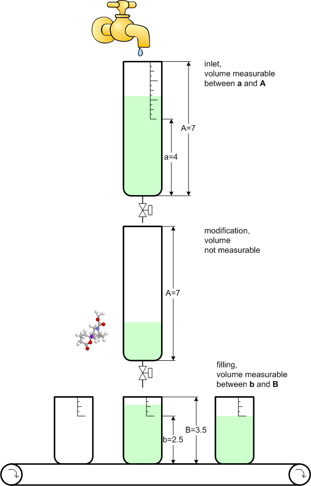

kann jemand eine allgemeine Lösungsstrategie vorschlagen? Oder zumindest
die Aufgabe einer Disziplin zuordnen (nichtlineare Programmierung?)? In
der Realität soll ein Rechner die Lösung automatisch vorschlagen. Wie
gesagt - echte Aufgabe aus der Industrie.
Task: A small fluid product production plant consists of filling,
modification and dosing stages. You are operating this plant.
Today, your production order is exactly S=10 tons. In the inlet stage,
you are able to fill between a=4 and A=7 tons. In the modification
stage, there is no measurement; you have to remember what you fill in
and out. In the filling stage, you can dose between b=2.5 and B=3.5
tons.
You are not allowed to let the fluid flow anywhere but into these target
vessels. You are expected to let in and fill out exactly the ordered
amount, with no leftovers at the end. You are allowed to have some
leftover in the modification stage between steps, but not allowed to
overfill any stage. In what steps will you do it?
Possible answer: 10 = 5 + 5 = 3⅓ + 3⅓ + 3⅓
1.  inlet 5 tons (o.k., 5 > a)
2.  modify 5 tons
3.  fill 3⅓ tons (o.k., b < 3⅓ < B); 1⅔tons remain in modification stage
4.  inlet 5 tons (o.k., 5 > a)
5.  modify 5+1⅔ tons (o.k., 5+1⅔ < A, no overfill)
6.  fill 3⅓ tons (o.k., b < 3⅓ < B)
7.  fill 3⅓ tons (o.k., b < 3⅓ < B) (o.k., no leftover)
Generalized task: for given minimal inlet quantity a and order size S,
find out if production without leftovers and overfills is possible. If
yes, find a suitable sequence of steps inlet and fill steps. Priorities:
- (most important) as few as possible fill steps
- equal fill quantities
- as few as possible inlet steps
- (least important) equal inlet quantities
More difficult case: S=23, a=5. Possible in 7 fill steps, but requires
non-equal inlet steps.
