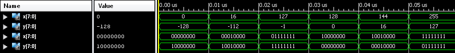

So ginge das:
    port (...
          x : in  std_logic_vector(7 downto 0);
          y : out std_logic_vector(7 downto 0);
signal u : unsigned (7 downto 0);
signal s : signed (7 downto 0);
  u <= unsigned(x);
  s <= signed(u-to_unsigned(128,8));
  y <= std_logic_vector(s);
Aber (hmhm... räusper...) das Invertieren des MSB macht das selbe...
(siehe die unteren beiden Zeilen im Screenshot der Simulation)
