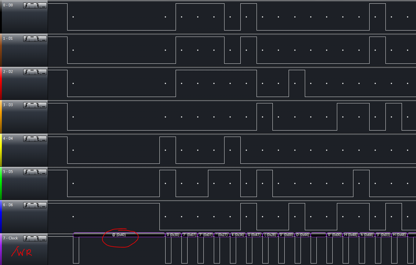

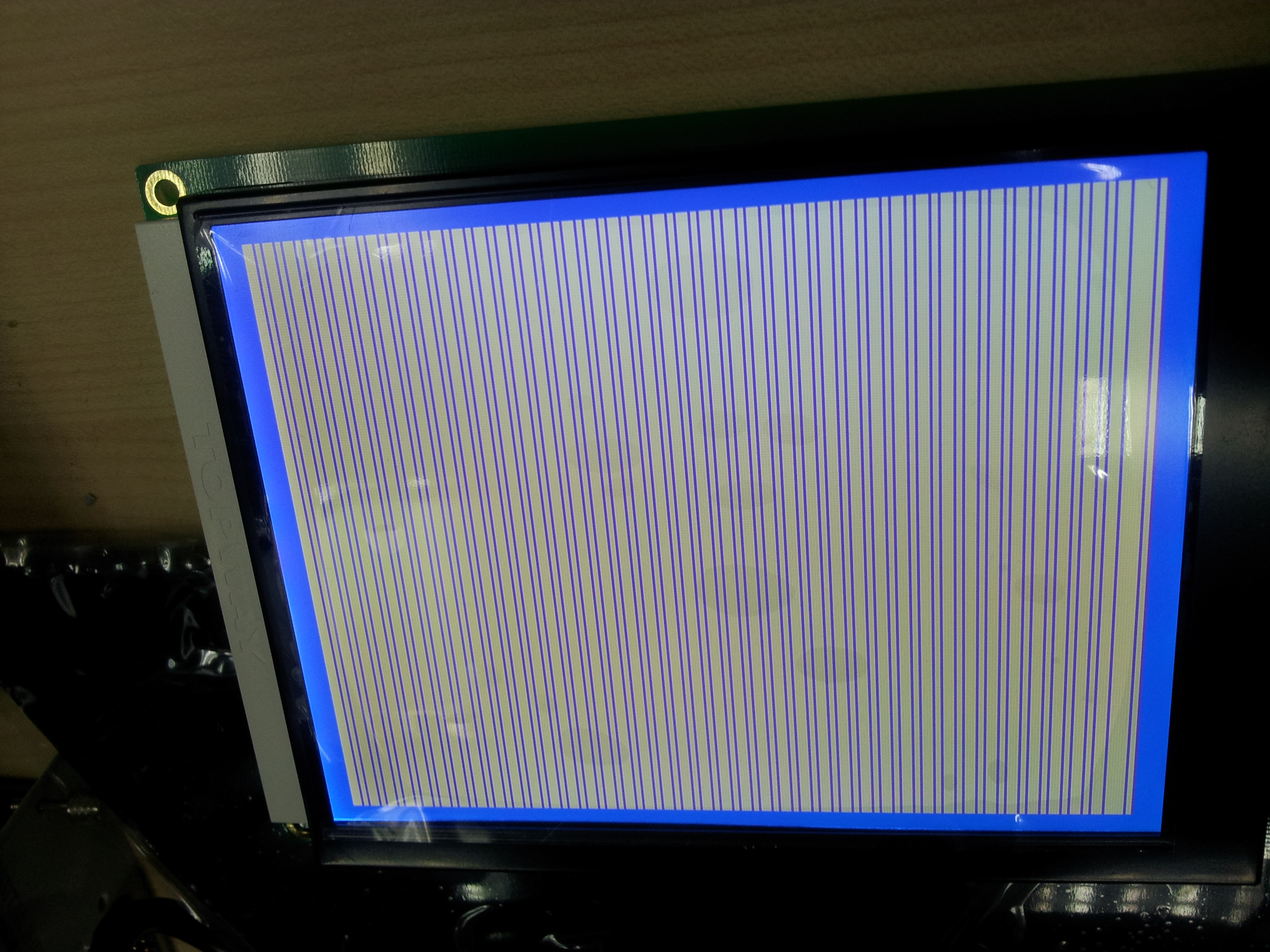

Attached with my coding and the picture i had initial(not success all
the time).
This screen only show up on certain number of try.
I start my program and kill it, and start again, until this screen
showed.
I am using parallel pin with parapin library.
anyone can help on this ?
* after initial, i kill my program without RST again and run a 0x58 and
0x59 loop (command), it work.
* after reset crystal is in high states, after 0x40, crystal was
measured, it osilate in 10MHz
I am using TOPWAY LM2088E
timing diagram clk is the /WR
i had tight my RD to the VDD

just for information, I only able to use screen on and screen off after
a random success initialization process.
I had no clue due to the command for 0x58 and 0x59 just work well, 0x40
and a delay can make the crystal start oscillate. But the initialization
process not really working, and no even a cursor in text mode and only
show the screen i attached on the last post.

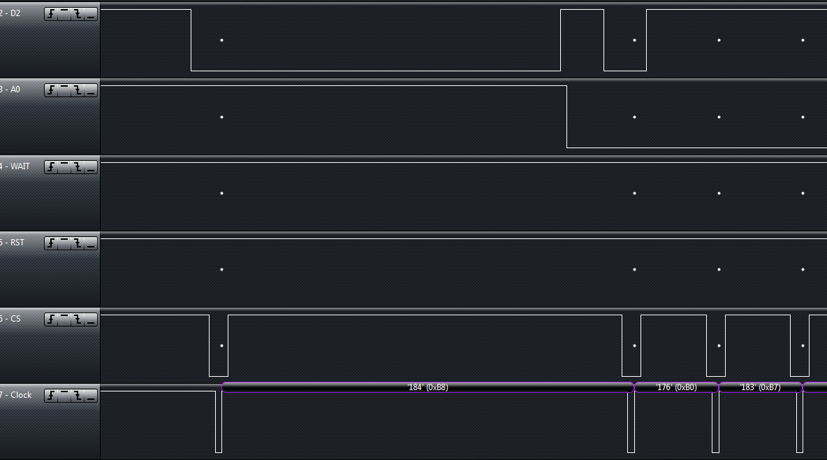

OP #3251375
I had try everything i can done, Now I am using 18F4520 now to generate
more sharp output.
Same to parallel port, only able to make the oscillator to work after
reset follow with a 0x40 command.
note 1: WR toggle inside the CS toggle.
WAIT pin produce a pulse on each WR fallig edge.
any idea on this ?
I really hope someone can give me a set of working initialization signal
capture so I can generate the same pattern of wave to light up my LCD.
At least using the same timing as possible.
OP #3260270
Problem solve:
The supply for GLCD and signaling output must be the same. Common ground
and voltage.
Different controller with different command sequence
18F4520:
/CS - /WR - CS - WR
PARAPIN:
/CS - /WR - WR - CS
Conclusion:
Check the WAIT pin to determine the pattern of sending is  a valid
communication or not.
WAIT signal is triggered when the WR pin low. A small pulse is detected.
