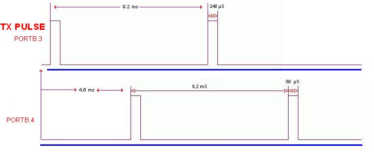

Here is the pulse that made
#3370688
Well. That is obviously not correct.
First of all, draw a picture which is to scale!
The most important thing is: do both pulses alwas start at the same
time? Then you can get away with a simple solution which works with
delays. If not, then you need something fancier using timers to do the
timing.
But do yourself a favour and start with a scale drawing showing at least
2 pulse periods.

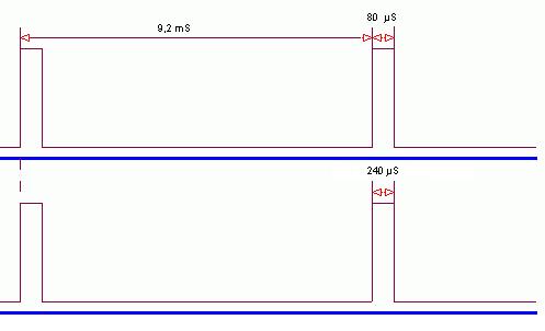

sirlakidis giannis schrieb:
> NO the two pulses do not start together..
> The PULSE on potb.4 must start at HALF SIZE POINT OF THE ROUTE of
> portb.3
On each and every pulse sequence.
SO the chain of events is
do
  b3 to 1
  wait 40µs
  b4 to 1
  wait 40µs
  b3 to 0
  wait 200µs
  b4 to 0
  wait 9.2ms - 280µs
loop
both pulses are intermixed to each other. But if you follow the programm
over time, you will see, that b3 has a total on-time of 80µs and b4 has
a total on-time of 240µs and starts 40µs after the pulse b3 has started.
Thats why I told you to make drawing. Following that drawing on the time
line from left to right you would have figured it out all by yourself,
which event takes place when and what the timing has to be from one
event to the next one.

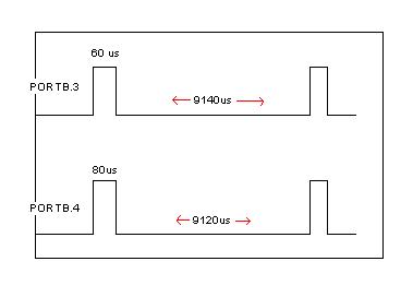

#3370899
> SIMPLE hard to understand
I see, you have done your homework.
Now go a step further, put the 2 timelines in context, introduce a
timeline for 1 cycle and do the math (see picture)
once you know the order of events that have to take place and how many
time has to pass by between the events, you are actually ready ... to
put all this in a programm and off you go: the µC ist producing exactly
the pulses as specified in your diagram. Just follow the timeline from
left to right for 1 cycle. It will tell you what to do and how long to
wait until the next action hast to occour.
Well not exactly, the µC will be off by a few µs, depending on the clock
speed of the µC, but I guess it will be close enough.
Where is the problem?
Preperation and doing the math BOFORE you start coding is one of the
keys to success.

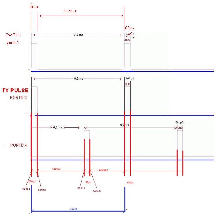

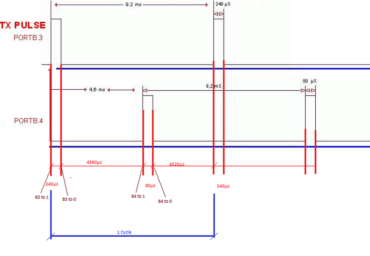

OP #3372215
Good evening Karl Heinz..
Here's the finished project..
$regfile = "attiny45.dat"
$crystal = 1000000
Config Portb = Output
Const
Const Offtx = 4360
Const
Const Offs = 4520
Do
Portb.3 = 1
Waitus Ontx
Portb.3 = 0
Waitus Offtx
Portb.4 = 1
Waitus Ons
Portb.4 = 0
Waitus Offs
Portb.3 = 1
Loop
22
23
End
Now I want to do the following..
NEED PROTO YOU thank you very much..
Well΄ now I want to change the duration of the pulse ΤΧ with a switch.
example When arming a portb.1 ena portb.2 in +5 volt then I have a
different UP time in tx pulse..
Show timetable..
#3372250
Well, it is pretty much the same.
Make a drawing. figure out, which value computes from which other value,
do the math and ... you have all that is needed.
I will not do it for you, since i strongly believe that every 8 year old
child can do that. It really is THAT simple as to add or subtract a few
numbers where all you need to do is figure out which numbers have to be
added or subtracted. If you can't do it in your mind, then make a
drawing. That drawing will tell you all that is needed.

#3373782
Your image is misleading.
You still have not learned, that an image should show all relevant
facts.
And in this case, fact is that there is no longer a fixed phase
relationship inbetween those 2 pulses.
Therefor you have to switch to a different strategy.
Your best option is to use timers, for what you want to do.
#3373820
The point is:
the whole thing is not THAT simple, because there are a number of
concepts involved. Especially with a Tiny45, which does not have a 16
Bit Timer.
If you are not experienced with using timers, it is rather long lerning
curve and not something I can express in 30 oder 40 words.
