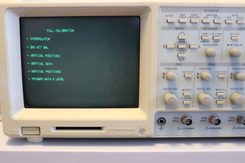

Glückwunsch . Vielleicht hat jemand die technische Dokumentation für den Hitachi VT-7104? Schaltpläne und vollständige Reparatur- und vollständige Kalibrierungsanweisungen sind erforderlich. Das Oszilloskop schaltet sich ein, friert aber auf dem Bildschirm „VOLLSTÄNDIGE KALIBRIERUNG“ ein. ICH WERDE FÜR JEDE HILFE SEHR DANKBAR SEIN.

Does anyone have a Service manual for VC-7104? I had problems with vertical position1 and vertical gain. Rest of calibration works fine. But without any manual proper setting it is quite difficult. I replaced all electrolytic capacitors and coils. With calibration menu I was able to set most settings around 0 points but that took a while.
To avoid calibration at startup which hangs out probably turning on with pressed menu button or some other around should help. Just press the button and turn unit on. But initial calibration takes about 5 minutes so maybe wait little longer as it not actually hangs. There’s hidden calibration menu when press simultaneously left,right and up buttons around menu.
