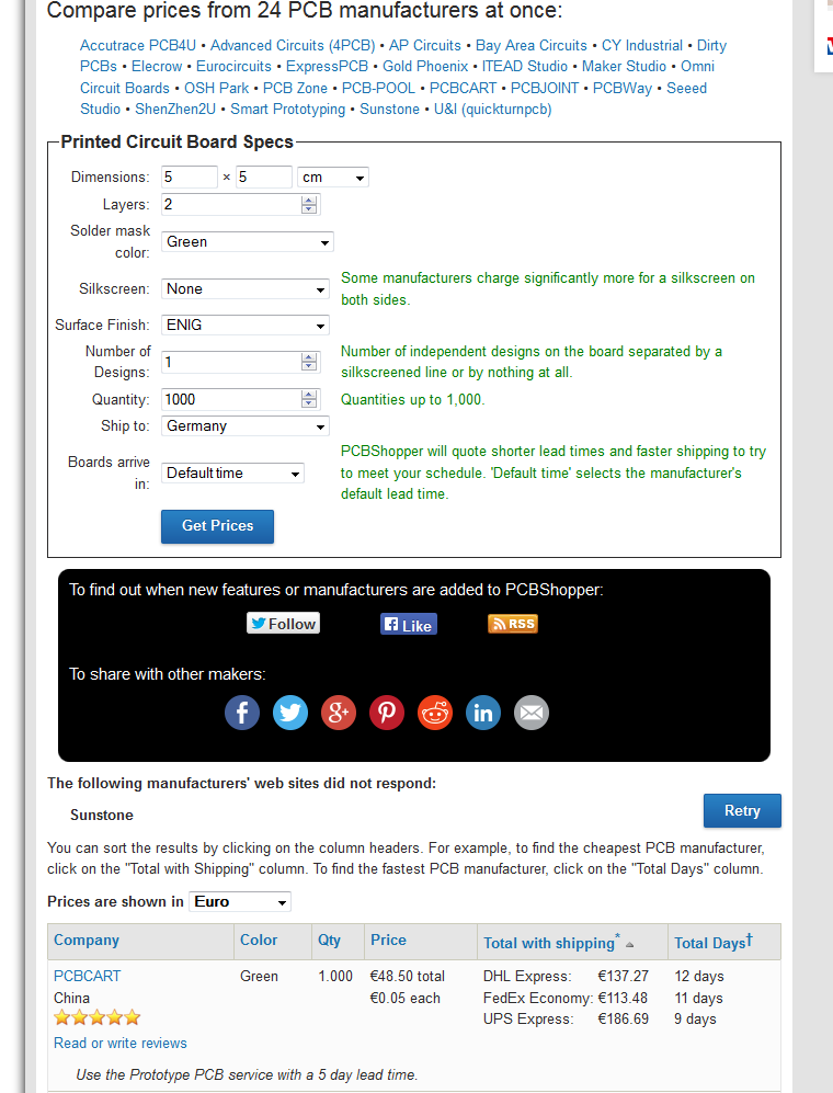

I am the person who runs PCBShopper.com. If Google translated the German correctly, "Guest" says that the prices on http://PCBShopper.com are not correct. This is unlikely. PCBShopper gets PCB prices directly from the manufacturers' web sites, the same way your browser gets a price when you fill out a quote form. The exception is shipping costs. In some cases, PCBShopper can not get shipping costs from the manufacturer's site. And so PCBShopper calculates the weight of the PCBs and gets shipping costs from shipping services. Those prices will be different from what manufacturers charge, but they should be close. But if you do ever see a mistake on PCBShopper, please let me know about it! There are links to "Contact Us" on the PCBShopper site. Let me know the specs you entered for your board, and which manufacturer you think has the wrong price. In most cases, I fix such problems in less than a day! But I can't fix it if I don't know about it. - Bob Alexander
#4151280
Bob Alexander schrieb: > This is unlikely. PCBShopper > gets PCB prices directly from the manufacturers' web sites, the same way > your browser gets a price when you fill out a quote form. Hi, as an example ---look the pics
#4151291

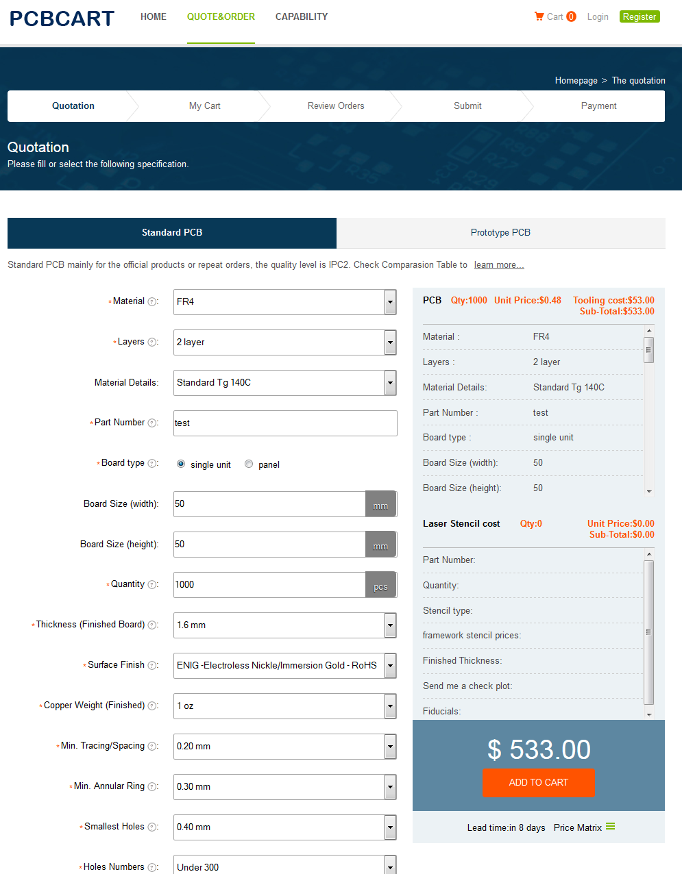

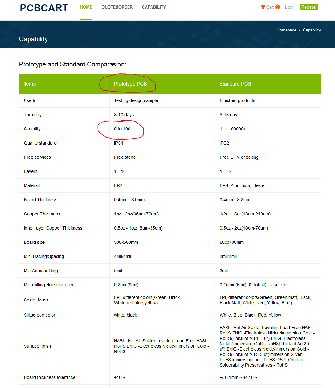

and as you wrote on your site: 'Use the Prototype PCB service with a 5 day lead time.' You cant use the Prototype PCB Service for quantities >100

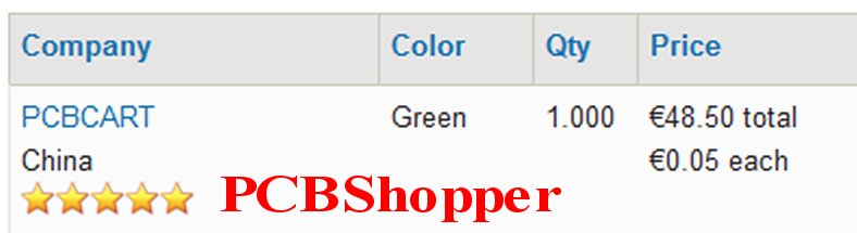

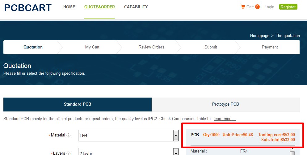

... schrieb: > as an example ---look the pics Ich hab mir mal die Bilder angesehen.Der Preis per Unit ist falsch(um den Faktor 10!).Wahrscheinlich fehlerhaft von PCBCART uebermittelt. Sogenannte "Tooling costs" - also Werkzeugkosten - werden wahrscheinlich von PCBShopper generell nicht in die Berechnung mit einbezogen.Aber das ist nur eine Vermutung..... If you look on PCBCARTS website they charge &0.48 per unit if you order 1000 boards.Without shipping costs this would amount to $480. ON PCBShoppers website the price per unit is €0.048(!) (Dollar ~ Euro) therefore the discrepancy.To me it looks like PCBCART is at fault for not transmitting the correct pricing for a single unit. Also the tooling costs are not included,which might not be handled properly by PCBShoppers website.
#4151755
... schrieb: > as an example ---look the pics Thank you for showing me the error. PCBCART was returning data I didn't expect when I tried to get prices. I have fixed the problem and PCBShopper now shows correct prices for large quantities at PCBCART. I don't normally read this forum (obviously) so if you ever see errors in the future, please use the Contact Us link on PCBShopper.com. PCBShopper is not a company; it's one guy - me. I'll make mistakes, but I'll fix them when I know about them. - Bob
