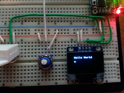

Here is the code now a bit simplyfied.
A potentiometer in Pin3 from attiny and the oled display connected.
Hellow World works but sensor Values gives Letters instead of Numbers.
Any ideas how i get the value in numbers between 0-255 ?
von kemi (Gast)
char str[5];
  oled.cursorTo(15,19);
  oled.printString( itoa(sensorValue, str, 10));
did the trick!
