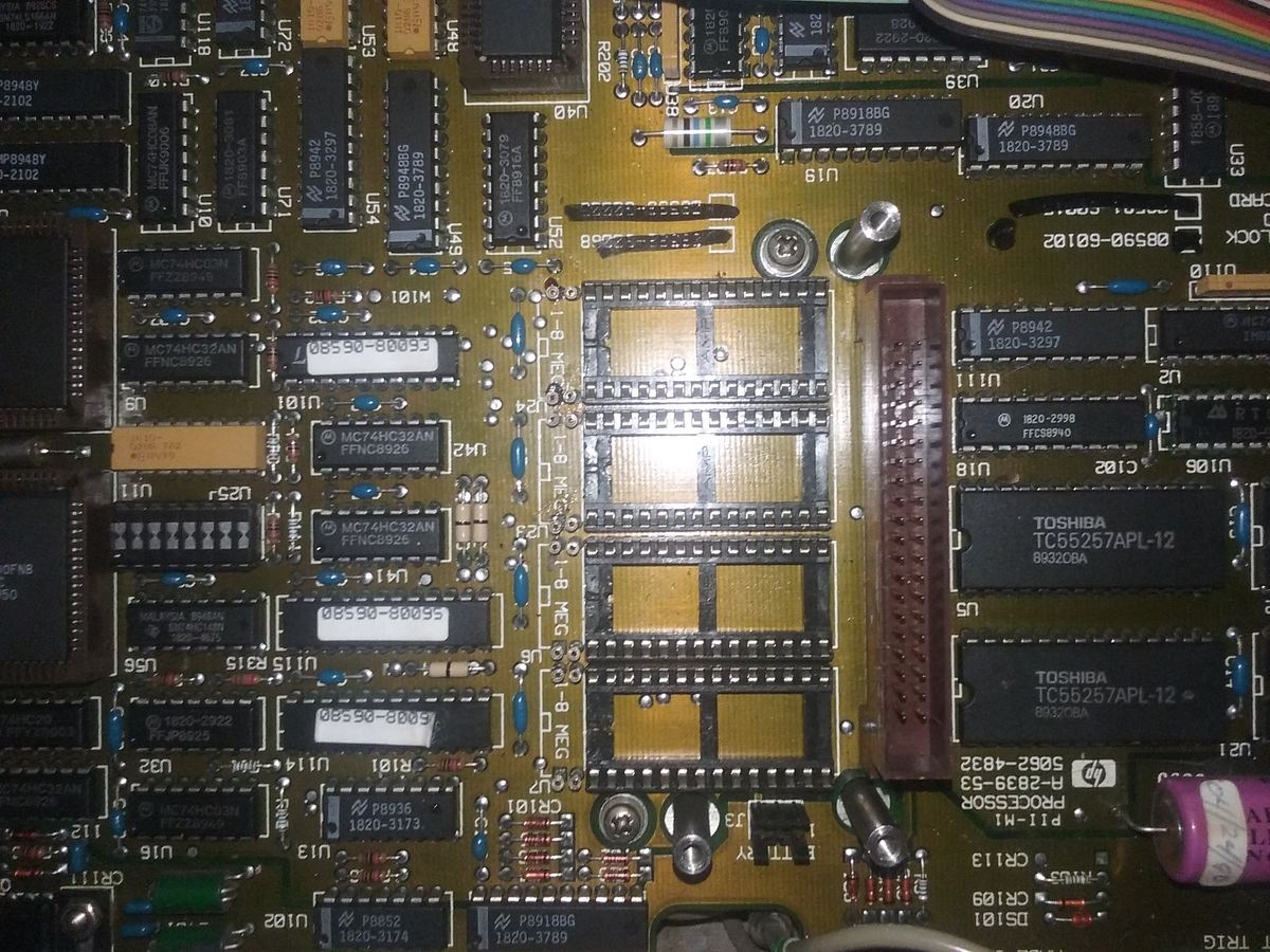

Hello
I need firmware ICs (U6,U7,U23,U24) to spectrum analyzer HP 8591A. This
is version from y.1990. The board type is 08590-60102. Eprom type is
27C512.
Has anybody this analyzer where is possible read memories? Or knows
anybody where is possible to download?
FW from another analyzers (8591E, 8592...) are not compatibles. Must be
only 8591A .
Thanks!

Hello, thanks you, but not working. On my board 08590-60102 there are
only possible to insert 27C512. The rest of pins are unsoldered. I tried
to solder the rest pins (27C010 is longer), but it is not working too.
Probably becaouse different logic in PAL array. On my board there is
08590-80094 and 08590-80095 PALs. These PALS are adreesing EPROMs, so
the larger EPROMS probably can not be used. You can see my board on the
attached photo.

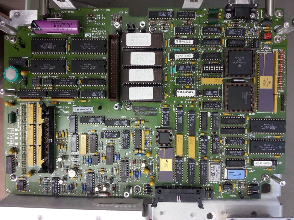

On my board there also is the PAL 08590-80095. But in stead of your
08590-80094 I have a PAL named 08590-80159. That is your problem. Sorry,
but I have no access to the contents of this PAL.

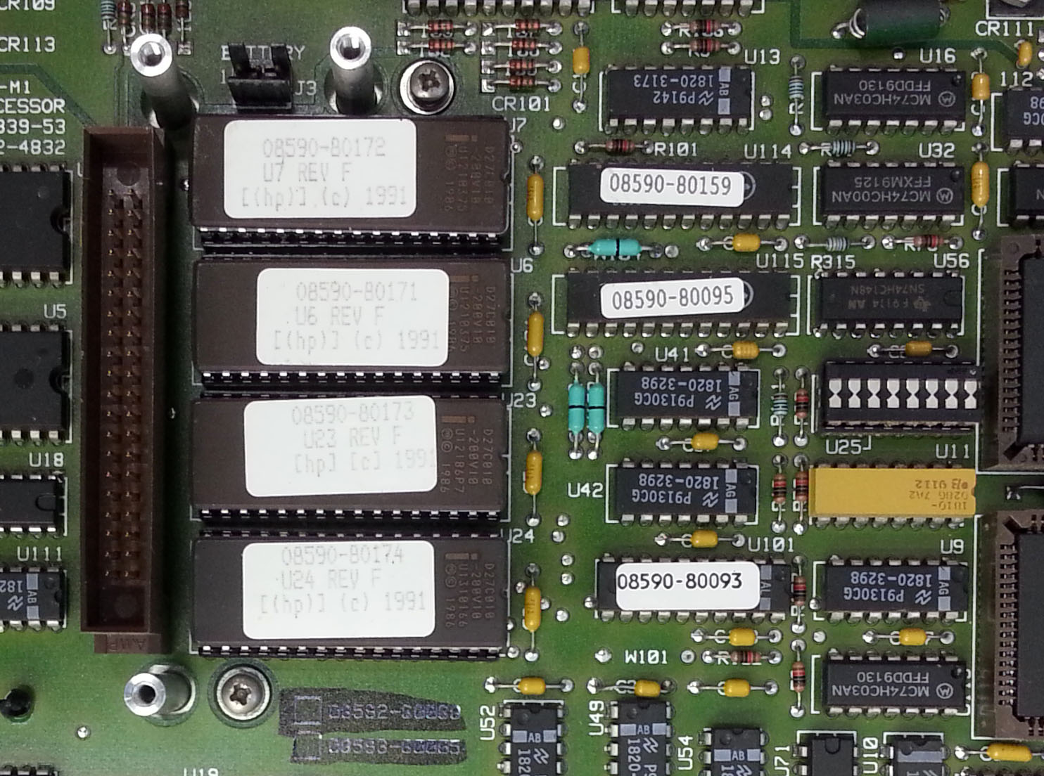

Dr.Kater , can you make a photo of your board near to the EPROMs where
are viible PALs and RAMs?

Attached are JEDEC and PLD files for the 08590-80159. This has to be
burned into a 22V10 type PAL.
Zdenek, send me a personal message in case you need a programmed chip.
Hello, friends,
after time, I found a lot of HP 8590/ 8591E analyzers and everywhere I
uploaded EPROMS. Si now I have all for version
08590 900103: 08590-80154 .. 08590-80157  (it means 512kbit)
and
08590 910717  08590 - 80171 .. ¨08590 - 80174 (1Mbit)
and
08590 940822: 08590-80228 .. 08590-80231  (1Mbit)
and
08590 950914: 08590-80244 .. 08590-80247  (2Mbits!!)
and
08590 980615 (2Mbits)
Who want the dump, write me. But important is to see original EPROM
size, in case of another size or counts of EPROM, you must change PAL
IC. I have PAL for Card reader, for ID for tracking generator and in
worst case when somebody need, I can read pal from mainboard.
