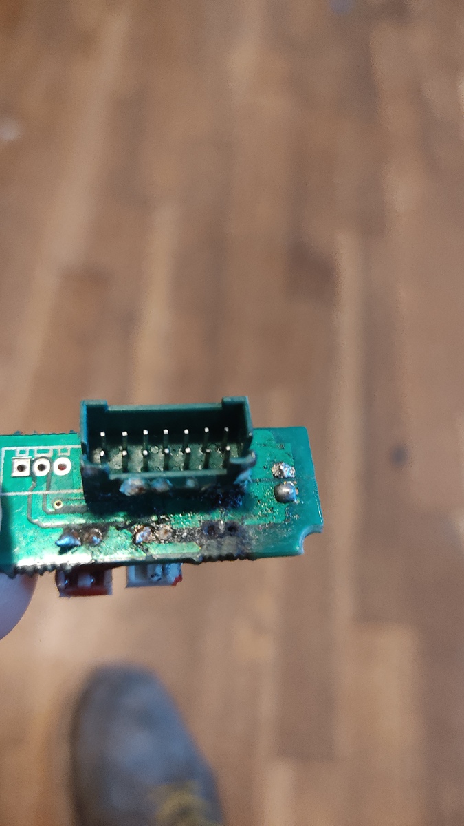

Bei meinem 3D drucker ist hier die Platine
defekhttps://www.ebay.de/i/174561363199?var=473768612898&ul_ref=https%253A%252F%252Frover.ebay.com%252Frover%252F1%252F707-53477-19255-0%252F1%253Ftype%253D4%2526pub%253D5575407436%2526toolid%253D20006%2526campid%253D5338703919%2526mpre%253Dhttps%25253A%25252F%25252Fwww.ebay.de%25252Fi%25252F174561363199%25253Fvar%25253D473768612898%2526customid%253Ds%25253AGS%25253Bgc%25253ACj0KCQiAv6yCBhCLARIsABqJTjZtq0v3PWTdS3RiGAgeJpN2DFIatwyD2HwVlbx1rg3BthadoyF9q8oaAoXREALw_wcB%25253Bpt%25253A1%25253Bnott%25253A1%2526ul_ref%253Dhttps%2525253A%2525252F%2525252Frover.ebay.de%2525252Frover%2525252F1%2525252F707-53477-19255-0%2525252F1%2525253Ftype%2525253D4%25252526pub%2525253D5575407436%25252526toolid%2525253D20006%25252526campid%2525253D5338703919%25252526mpre%2525253Dhttps%252525253A%252525252F%252525252Frover.ebay.com%252525252Frover%252525252F1%252525252F707-53477-19255-0%252525252F1%252525253Ftype%252525253D4%2525252526pub%252525253D5575407436%2525252526toolid%252525253D20006%2525252526campid%252525253D5338703919%2525252526mpre%252525253Dhttps%25252525253A%25252525252F%25252525252Fwww.ebay.de%25252525252Fi%25252525252F174561363199%25252525253Fvar%25252525253D473768612898%2525252526customid%252525253Ds%25252525253AGS%25252525253Bgc%25252525253ACj0KCQiAv6yCBhCLARIsABqJTjZtq0v3PWTdS3RiGAgeJpN2DFIatwyD2HwVlbx1rg3BthadoyF9q8oaAoXREALw_wcB%25252525253Bpt%25252525253A1%25252525253Bnott%25252525253A1%25252526customid%2525253Ds%252525253AGS%252525253Bgc%252525253ACj0KCQiAv6yCBhCLARIsABqJTjZtq0v3PWTdS3RiGAgeJpN2DFIatwyD2HwVlbx1rg3BthadoyF9q8oaAoXREALw_wcB%252525253Bpt%252525253A1%252525253Bnott%252525253A2%25252526gclid%2525253DCj0KCQiAv6yCBhCLARIsABqJTjZtq0v3PWTdS3RiGAgeJpN2DFIatwyD2HwVlbx1rg3BthadoyF9q8oaAoXREALw_wcB%25252526srcrot%2525253D707-53477-19255-0%25252526rvr_id%2525253D0%25252526rvr_ts%2525253D2a8cd5401780a6e58be1030affedc952%2526dashenId%253D6776408038711570432%2526dashenCnt%253D1%2526srcrot%253D707-53477-19255-0%2526rvr_id%253D2846640973411%2526rvr_ts%253D2a8cd7701780aad71d57a5f1fff93453
Also da wo man die heizung anschließt ist kein metall mehr zum neu
anlöten weil das hat sich vom pcb gelöst
Nur finde ich das Teil ist nichtmal die Hälfte wert von den was der
verlangt
Wie kann ich das lösen?

Das kommt drauf an, welches Rastermaß der Stecker hat. Für RM2.5 gibt es
Lochrasterplatinen.
Bevor du dort etwas erneuerst, solltest du dir Klarheit verschaffen, was
der Grund für den aktuellen Zustand ist. Besitzt du einen Schaltplan zu
dem Teil oder kannst ihn aufnehmen?

Schwierig. Wenn ich die Platine so ansehe sind deine Lötkünste wohl
nicht die besten.
Es gäbe die Möglichkeiten
die Platine zu flicken. Ggf mit Litze die dinge verbinden die auf der
Platine kaputt sind.
Die Platine sofern da keine Bauteile drauf sind durch direktes verbinden
der Kabel zu umgehen
Die Platine nachzeichnen und 10 Stück für wenige Euros beim chinaman zu
bestellen. Wenn du die restlichen verkaufst hast du vielleicht sogar was
verdient.
Oder du schaust ob du so einen Drucker als defekt kaufen kannst und hast
gleich noch mehr Ersatzteile.
