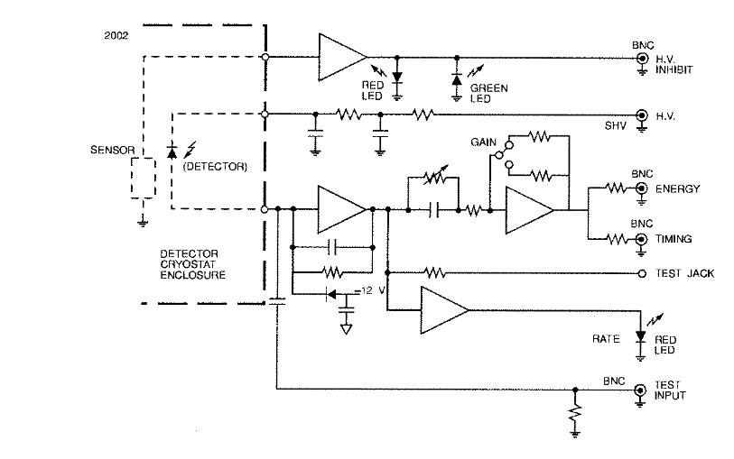

Detektors:
Anbei noch ein Blockschaltbild des Detektors
HV INHIBIT OUTPUT: Provides a logic signal to turn off High Voltage
Power Supply when detector temperature reaches -160°C and is cooled.
Output is +12V when temperature is correct, and <+0.5V under fault
condition, capable of sinking 10mA. Installing optional 10kOhm resistor
changes high level from +12 to +5V. High voltage inhibit ground is
isolated from signal ground by 1mH, 30Ohm inductor to prevent induction
of ground loop noise.

Gast #6840130
Ich denke, so wird es klappen:
                               +-----------------o Inhibit Eingang
Sensor Ausgang o---[===]-----|
           GND o---------------+-----------------o GND
                  10kΩ       BC337-40
