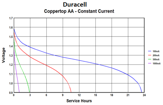

von Geert H. (geerth)
According to Wikipedia the capacity is load dependant: AA can vary from
3000 at low drain to 700mAh at 1A.
https://en.wikipedia.org/wiki/Alkaline_battery
An example from stackexchange (see figure Duracell)):
https://electronics.stackexchange.com/questions/571226/how-many-amperes-can-an-alkaline-aa-battery-supply
Energizer datasheet shows the same trend, at 500mA the capacity is
reduced to 1500mAh, where it does 3000mAh at 25mA.
https://data.energizer.com/pdfs/e91.pdf
