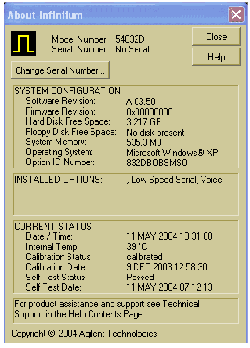

Key facts:
Agilent 54832D
SN MY5130xxxx
VIN # A52 Rev. A04.20
WinXP Pro ( Licence Sticker in rear Side)

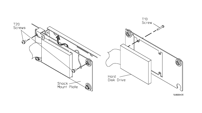

Does Agilent sell replacement parts and software?
Here ist just a drawing of the mechanical replacement on pg. 136:
https://www.manualslib.com/manual/2061617/Agilent-Technologies-54830-Series.html?page=136#manual
looks like a usual notebook harddisk.

I can achieve. You are right with your assumtion. The HDD looks like a
typical HHD with parallel port connector, like the old laptop HDD's had
had before they switched to SATA. That's the reason why I guess I will
find a propper HDD more easy than the software. Thanks for your answer.
