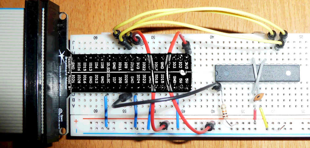

Raspberry Pi as AVR programmer: Close Look up Breadboard: Yellow cable: SPI (MOSI/MISO/SCLK) Black: Reset_n (note PullUp) Red: 3V3 from RasPi blue: gnd
ATMege 328P running on internal oscillator, power supply by RasPi (note 100nF cap between Vcc and GnD
