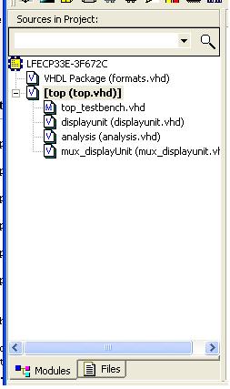

in der top.vhd habe ich folgenden eintrag:
bb: analysis
  port map(
      analysisClk            => Clk_G,
      analysisReset          => S_Reset,
      analysisHSync          => internH,
      analysisVSync          => internV,
      analysisDE            => internDE,
      aResult_totalPix        => anaResult_pixTotalHorizontal,
      aResult_totalLines        => anaResult_linesTotalVertical,
      aResult_activePix        => anaResult_pixHorizontal,
      aResult_activeLines        => anaResult_linesVertical,
      aResult_hSync          => anaResult_syncPixHorizontal,
      aResult_vSync          => anaResult_syncPixVertical,
      aResult_horizontalFrontPorch  => anaResult_frontPorchHorizontal,
      aResult_horizontalBackPorch    => anaResult_backPorchHorizontal,
      aResult_hSyncPolarity      => anaResult_syncPolarityHorizontal,
      aResult_verticalFrontPorch    => anaResult_frontPorchVertical,
      aResult_verticalBackPorch    => anaResult_backPorchHorizontal,
      aResult_vSyncPolarity      => anaResult_syncPolarityVertical,
      formatChange          => formatChange,
      resetFormatChange        => resetFormatChange
22
23
24
ich will sozusagen die anliegen signal einfach nur durchreichen... d.h.
von den "out"-ports (analysis.vhd) zu den "in"-ports
(mux_displayUnit.vhd) weiterleiten ohne diese irgendwie zu verändern
oder sonst...
leider bekomm ich folgende fehlermeldung:
top.vhd(210): ERROR: anaresult_pixtotalhorizontal with mode 'in' cannot be updated
top.vhd(211): ERROR: anaresult_linestotalvertical with mode 'in' cannot be updated
top.vhd(212): ERROR: anaresult_pixhorizontal with mode 'in' cannot be updated
top.vhd(213): ERROR: anaresult_linesvertical with mode 'in' cannot be updated
top.vhd(214): ERROR: anaresult_syncpixhorizontal with mode 'in' cannot be updated
top.vhd(215): ERROR: anaresult_syncpixvertical with mode 'in' cannot be updated
top.vhd(216): ERROR: anaresult_frontporchhorizontal with mode 'in' cannot be updated
top.vhd(217): ERROR: anaresult_backporchhorizontal with mode 'in' cannot be updated
top.vhd(218): ERROR: anaresult_syncpolarityhorizontal with mode 'in' cannot be updated
top.vhd(219): ERROR: anaresult_frontporchvertical with mode 'in' cannot be updated
top.vhd(220): ERROR: anaresult_backporchhorizontal with mode 'in' cannot be updated
top.vhd(221): ERROR: anaresult_syncpolarityvertical with mode 'in' cannot be updated
leider verstehe ich nicht warum der Fehler auftritt, die "modes"
(in/out) sind doch richtig oder ?
vielen dank im vorraus
grüße heiko

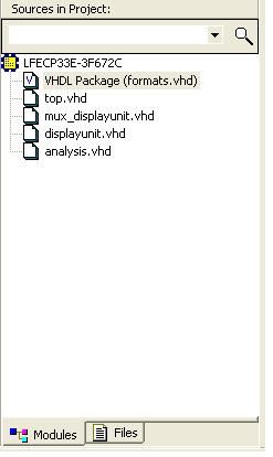

von Heiko (Gast)
Ich nochmal,
hab nochmal ne frage:
unzwar wenn ich folgenden eintrag:
dd: top
  port map(
      anaResult_pixTotalHorizontal       => tempAnaResult_pixTotalHorizontal,
      anaResult_linesTotalVertical      => tempAnaResult_linesTotalVertical,
      anaResult_pixHorizontal          => tempAnaResult_pixHorizontal,
      anaResult_linesVertical          => tempAnaResult_linesVertical,
      anaResult_syncPixHorizontal        => tempAnaResult_syncPixHorizontal,
      anaResult_syncPixVertical        => tempAnaResult_syncPixVertical,
      anaResult_frontPorchHorizontal      => tempAnaResult_frontPorchHorizontal,
      anaResult_backPorchHorizontal      => tempAnaResult_backPorchHorizontal,
      anaResult_syncPolarityHorizontal    => tempAnaResult_syncPolarityHorizontal,
      anaResult_frontPorchVertical      => tempAnaResult_frontPorchVertical,
      anaResult_backPorchVertical        => tempAnaResult_backPorchVertical,
      anaResult_syncPolarityVertical      => tempAnaResult_syncPolarityVertical
in der top.vhd hinzufüge verschwinden zwar alle Fehlermeldungen
allerdings geht auch irgendwie die struktur meines projektes flöten.
D.H. das meine top.vhd nicht mehr als toplevel-entity erkannt wird und
ich kann sie auch nicht als toplevel-entity setzen.
kommentiere ich obigen eintrag heraus bekomme ich zwar logischer weise
fehlermeldungen aber die struktur des projektes ist in ordnung.
bin etwas verwirrt ...
screenshots im anhang um das mit der projekt-struktur besser zu
verdeutlichen
von Andi Z. (duderino65)
das "dd : top" ist meiner meinung nach garnicht nötig.
du brauchst einfach von jeder entity (also analysis und mux) eine
instanz in deiner top.vhd.
dann machst du die zwischensignale und verbindest die port von jeder
instanz mit dem zwischensignal.
die top.vhd bruachst du ja nicht zu instanzieren.
ich hoffe ich hab dich recht verstanden.
mfg
Andi
