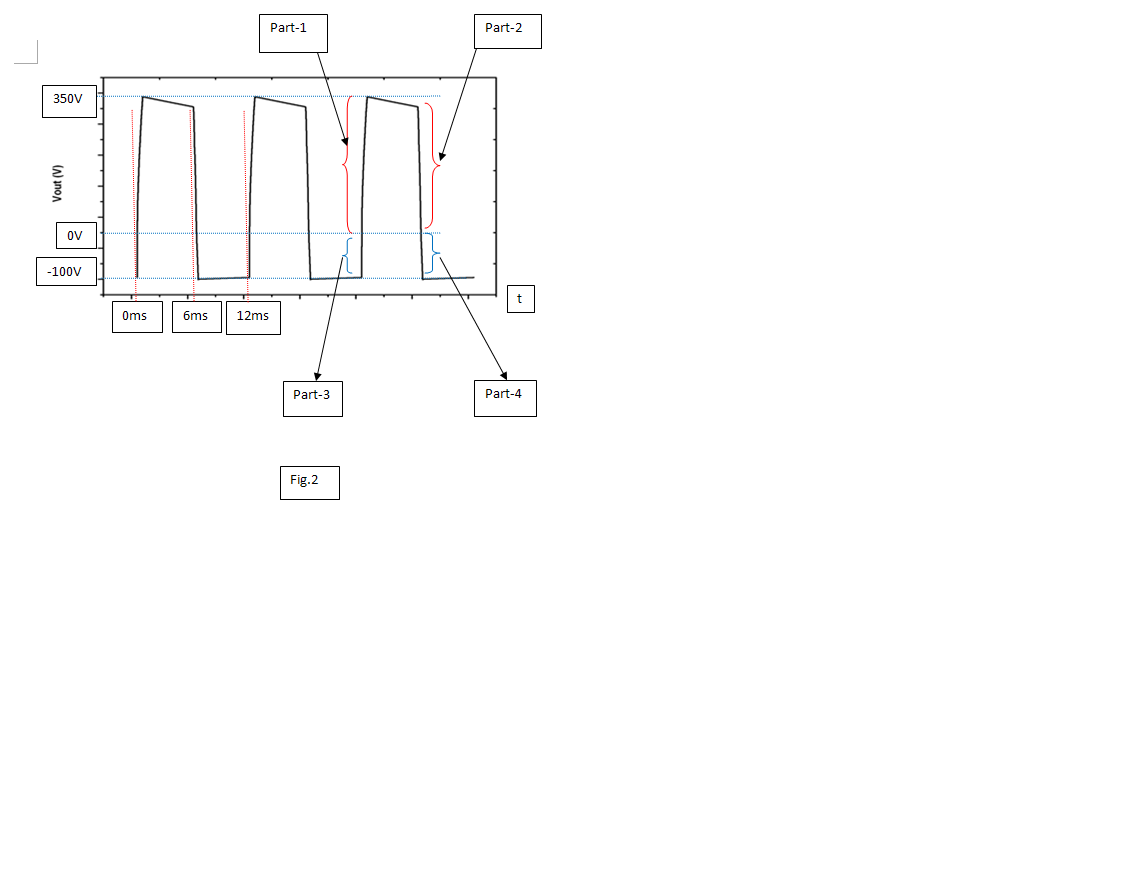

Hi
Could any body please help me with the following problem (You could
write in German :-)):
I have a circuit configured as shown in figure1.Network-1 charges  the
capacitor from 0V to 350V (part1 in Fig.2) and  discharges it(part2 in
Fig.2)
Network-2 charges & discharges the capacitor from 0V to -100V(part 4 in
Fig2) and vice versa(part 3 in Fig2).
During the operation of the network-1(parts 1&2), network-2 must be
completely disconnected from the capacitor and similarly the network-1
must be completely disconnected, while the network-2 is working(parts
3&4).
* charging & discharging period is about 12.5ms(80Hz).
* The connection & disconnection of the networks must happen in a very
short time.
*current flows in both directions in the path between networks and the
capacitor.
For this reason I selected switch-1 (MOSFET, N-channel) between
network-1 and the capacitor and switch-2(MOSFET, P-channel) between
network-2 and the cap.(for both switches source is connected to the
cap.).
switch-1 must be on during parts 1&2.It's source is floated and can
reach a voltage about +350V.It must be off while network-2 is
working(parts 3&4), where the source experiences a floating voltage from
0V to -100V.
Also,switch-1 must have a max-Vg>350V during parts 1&2 and min-Vg<-100
during parts 3&4.
A similar investigation for the switch-2 results in a min-Vg<-100 during
parts 3&4 and max-vg>350v during parts 1&2.
How can I realize  drivers for these switches?Drivers must be very small
and dissipate ultra-low power.
Or any other Idea to realize the switches, except using MOSFETs?
I'll be gratefull if any body can help me with this problem!
