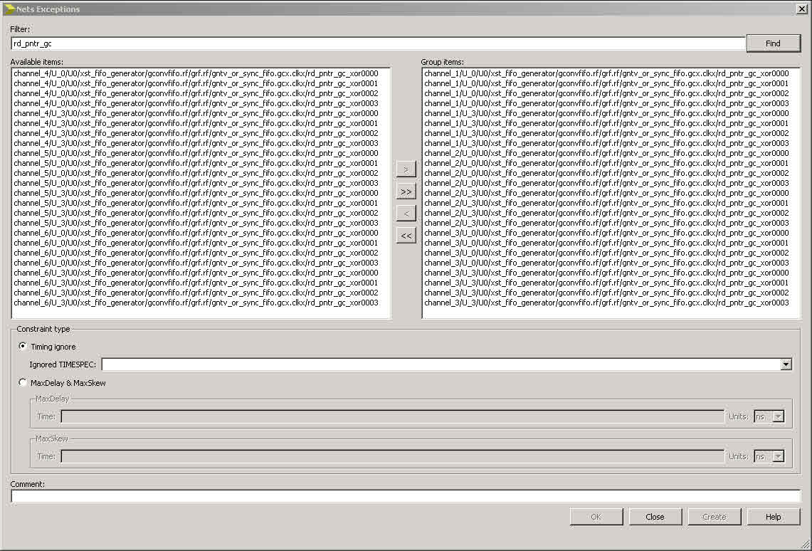

Auszug aus dem Timing Report:
Paths for end point channel_3/U_3/U0/xst_fifo_generator/gconvfifo.rf/grf.rf/gntv_or_sync_fifo.gcx.clkx/gsync_stage[1].wr_stg_inst/Q_0 (SLICE_X51Y69.BY), 1 path
 Slack (setup path):     -0.802ns (requirement - (data path - clock path skew + uncertainty))
   Source:               channel_3/U_3/U0/xst_fifo_generator/gconvfifo.rf/grf.rf/gntv_or_sync_fifo.gcx.clkx/rd_pntr_gc_0 (FF)
   Destination:          channel_3/U_3/U0/xst_fifo_generator/gconvfifo.rf/grf.rf/gntv_or_sync_fifo.gcx.clkx/gsync_stage[1].wr_stg_inst/Q_0 (FF)
   Requirement:          1.250ns
   Data Path Delay:      1.672ns (Levels of Logic = 0)(Component delays alone exceeds constraint)
   Clock Path Skew:      -0.380ns (1.817 - 2.197)
   Source Clock:         CLK_200_int rising at 5.000ns
   Destination Clock:    CLKFX_int rising at 6.250ns
   Clock Uncertainty:    0.000ns
   Maximum Data Path: channel_3/U_3/U0/xst_fifo_generator/gconvfifo.rf/grf.rf/gntv_or_sync_fifo.gcx.clkx/rd_pntr_gc_0 to channel_3/U_3/U0/xst_fifo_generator/gconvfifo.rf/grf.rf/gntv_or_sync_fifo.gcx.clkx/gsync_stage[1].wr_stg_inst/Q_0
     Location             Delay type         Delay(ns)  Physical Resource
                                                        Logical Resource(s)
     SLICE_X50Y68.YQ      Tcko                  0.676   channel_3/U_3/U0/xst_fifo_generator/gconvfifo.rf/grf.rf/gntv_or_sync_fifo.gcx.clkx/rd_q<0><1>
     SLICE_X51Y69.BY      net (fanout=1)        0.682   channel_3/U_3/U0/xst_fifo_generator/gconvfifo.rf/grf.rf/gntv_or_sync_fifo.gcx.clkx/rd_q<0><0>
     SLICE_X51Y69.CLK     Tdick                 0.314   channel_3/U_3/U0/xst_fifo_generator/gconvfifo.rf/grf.rf/gntv_or_sync_fifo.gcx.clkx/rd_q<1><1>
22
Die Folgenden constraints gehen nicht:
NET *rd_pntr_gc_<*> TIG;
NET "*rd_pntr_gc_<*>" TIG;
Fehlermeldung:
ERROR:ConstraintSystem:58 - Constraint <NET *rd_pntr_gc_<*> TIG;>
   [ucf/tasd_top.ucf(318)]: NET "*rd_pntr_gc_<*>" does not match any design
   objects.
Hat sich in der ISE 13.4 was zum Schlechten verbessert? Hat noch jemand
eine Idee?

Gast #2562928
Vor dem Update auf die neueste Version in Xilinx ISE 13.4 also
xilinx.com:ip:fifo_generator:8.4
hat folgendes getan:
NET "*/grf.rf/gcx.clkx/wr_pntr_gc<*>" TIG;
NET "*/grf.rf/gcx.clkx/rd_pntr_gc<*>" TIG;
Ich glaub ich schmeiß den Mist wieder raus und hol mir das Backup der
vom alten core.
#2562972
Hm, im Fifo User Guide der 8.3 steht das drin:
NET <fifo_instance>/xst_fifo_generator/gconvfifo.rf/grf.rf/gntv_or_sync_fifo.gcx.clkx/wr_pntr_gc<0> TIG;
NET <fifo_instance>/xst_fifo_generator/gconvfifo.rf/grf.rf/gntv_or_sync_fifo.gcx.clkx/rd_pntr_gc<0> TIG;
Offenbar ist da jetzt die interne Bezeichnung anders.
Gast #2563236
so kein Wunder
Es gibt kein Netz mit rd_pntr_gc sondern nur rd_pntr_gc_xor....
Und wenn man das Xor netz über den timing constraints editor hinzufügt
werden trotzdem fehlermeldungen geschmissen
-> ISE: LMAA
Ich gehe zurück auf den alten core und fertig
Danke für die Anteilnahme
