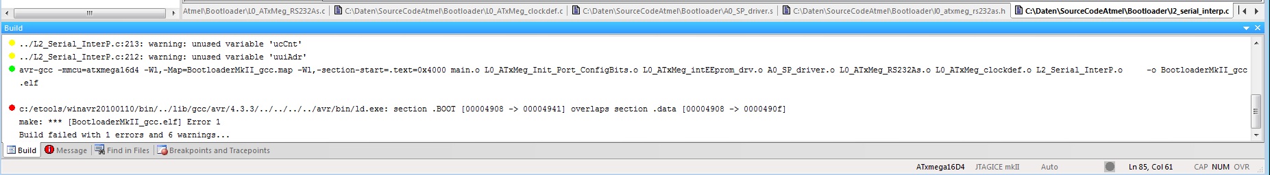

i am writing a New Bootloader for ATxMega Family.
With it i often have a linker problem, w. tells an overlapping of Memory
segments ( see picture Linker Error )
The code uses about 40% of the hole Boot-Range, and w. some small
changes in code, i get it running ( wondering ? )
So, why is there such a big difference between
char ucBuff[6] = "300225"; // generating linker Error
to ( working one )
char ucBuff[6];
ucBuff[0]='3';
ucBuff[1]='0';
ucBuff[5]='5';
Do you know the difference ? Why do i get the linker problem ?
