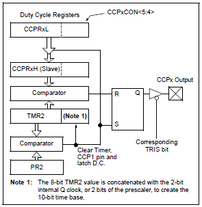

ich habe ein kleines Verständnissproblem zum PWM.
Ein Codeschnipsel:
/*    MCU: PIC18F2525
 *    EC-Clock: 40.000 MHz
 *    Compiler: MikroC PRO for PIC v.5.6.1
 *    LCD: HD44780 4x20 Zeichen             */
CCP1CON = 0x0C;     // PWM Register 0b00xy0000 wobei x,y <=> DC1B1,DC1B0
T2CON = 0b101;    // Timer ON, Prescaler 4
PR2 = 0xFF;
int temp = 0b 0000 0000 0000 0000;
CCPR1L = (temp >> 2);
CCP1CON.DC1B1 = (temp & 1);
CCP1CON.DC1B0 = (temp & 2);
Ist das nun ein 10bit wertiges PWM-Signal oder nicht?
Wenn nicht wie müsste es aussehen?
Vielen Dank schonmal!

14.5.2 PWM DUTY CYCLE
The PWM duty cycle is specified by writing to the CCPR1L register and to
the CCP1CON<5:4> bits. Up to 10-bit resolution is available. The CCPR1L
contains the eight MSbs and the CCP1CON<5:4> contains the two LSbs. This
10-bit value is represented by CCPR1L:CCP1CON<5:4>. The following
equation is used to calculate the PWM duty cycle in time:
PWM duty cycle = (CCPR1L:CCP1CON<5:4>)  TOSC  (TMR2 prescale value)
CCPR1L and CCP1CON<5:4> can be written to at any time, but the duty
cycle value is not latched into CCPR1H until after a match between PR2
and TMR2
occurs (i.e., the period is complete). In PWM mode, CCPR1H is a read
only register.
14.5.3 SETUP FOR PWM OPERATION
The following steps should be taken when configuring the CCP module for
PWM operation:
1. Set the PWM period by writing to the PR2 register.
2. Set the PWM duty cycle by writing to the CCPR1L register and
CCP1CON<5:4> bits.
3. Make the CCP1 pin an output by clearing the TRISC<2> bit.
4. Set the TMR2 prescale value and enable Timer2 by writing to T2CON.
5. Configure the CCP1 module for PWM operation.
Das bedeutet, dass dieses Code teilweise richtig ist.Da wird auf CCPR1L
und CCP1CON<5:4> bits geschrieben.Aber was da geschrieben wird ist mir
nicht ganz klar.

Gast #2863720
Ja, endlich!
Also um 10bit Auflösung zu erreichen muss man folgendes tun:
     int duty_ratio    // from 0 to 1023; also 0b0000 00nn nnnn nnnn
     CCPR1L     = duty_ratio >> 2;  // also 0b0000 0000 xxxx xxxx
     CCP1CON.F4 = duty_ratio;       // also 0b0000 00nn nnnn nnnx
     CCP1CON.F5 = duty_ratio >> 1;  // also 0b0000 00nn nnnn nnxn
Um die frequenz einzustellen:
     1/Clock * (PR2+1)  4  T2CON(prescaler) = 1/Hz
Das habe ich mit dem Oszi überprüft und validiert!
