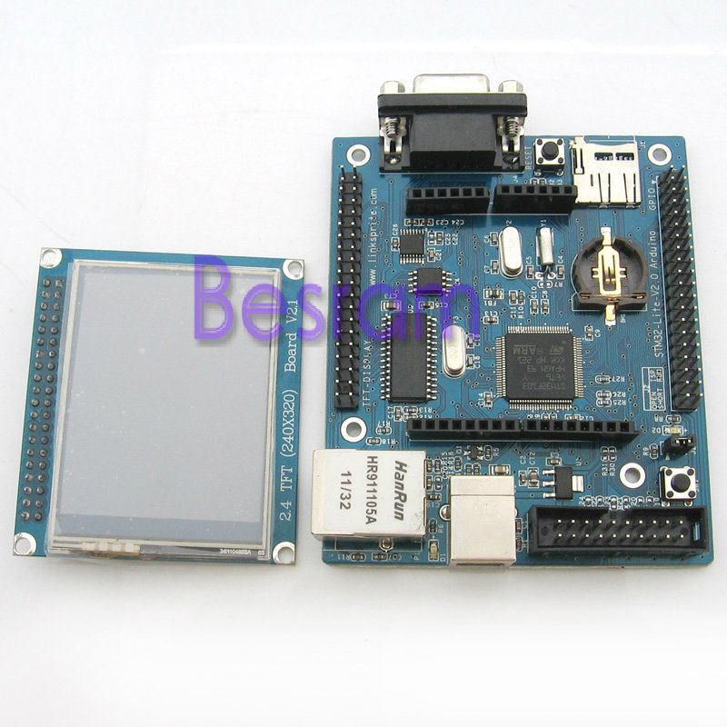

synoptik schrieb:
> STM32 Arduino
> http://i.ebayimg.com/t/Spruce-STM32-Arduino-Compat...
At the LinkSprite product page...
http://www.linksprite.com/product/showproduct.php?lang=en&id=86
... is stated " It can be used in GCC+Eclipse+openocd+openJtag and
Arduino enviroment! ", which means, a cheap FTDI JTAG adapter will work.
I will leave the decision which board to use up to you, since i don't
know how much experience you have with the one or the other processor
families and i don't know anythig about how much "numbercrunching
power", RAM and built-in features as ADC, PWM... your specific project
will need.
