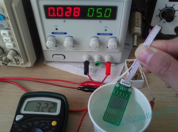

Congratulations to the ICStation team! They have developed this
wonderful water level sensor module
:http://www.icstation.com/product_info.php?products_id=3258 by great
efforts.This module with small size and high cost-effective is easy to
use.In this article, we will use the digital storage oscilloscope to
show you how the output voltage change with the immersion depth.What’s
more,we will show you an interesting actual application case.You will
have a clear idea of how this module to realize the function of water
level alarm.
Features: Simple ,Easy to use,Small size,Light, High Cost-Effective
Applicable Occasion:Water level alarm design
Parameter:
Working Voltage: DC5V
Working current: Less than 35mA
Type :  Analog sensor
Testing area: 40mm x 18mm
Working temperature: 10℃-30℃
Working moisture: 10%-90% without condensation
Fixing hole size: Φ3mm
Product size: 60mm x 22mm

Oh wow, a water level sensor working with conductivity....
How much do you trust in incrustation and long-term stability?
This is just a arduino toy and gadet, nothing to work with for a long
time, not even months or a year.
You will not find any water or liquid-level sensors with that working
principle in the field - and there is a good reason for that.
Trust it as far as you can throw it - 4 bucks for a corrosive PCB !!
OP (Firma: adaf) #3504660
Thank you for your reply!
This module is designed for the DIY hobbyist and provide them a low-cost
and easy-to-use water level detection scheme.The stability and
durability of this module can not reach the industrial standard.But we
use the high-quality PCB board to improve its stability and
durability.If you just want to DIY for fun,this module will be a good
choice.
