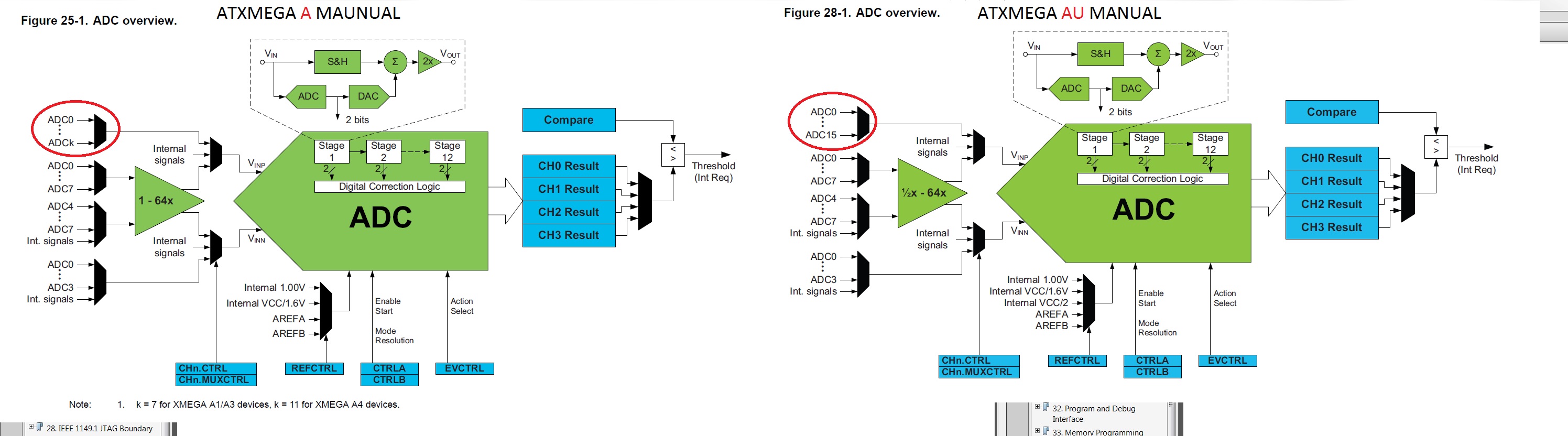

Hello there,
i´m wondering how to Access the ADC channels 8 to 15 on an AtXmega128A3
device. I´m not even sure, if they realy exist, since i found
conflicting documentation (from my Point of "understanding")
The application note AVR1324 on page 12 looks like there are only
channels from 0 to 7 in A devices.
http://www.atmel.com/Images/doc8378.pdf
Also the iox128a3.h file doesn´t give defines for more than 8 channels
(see ADC section "ADC - Analog/Digital Converter").
But on the other hand the document "ATxmega64A3U/128A3U/192A3U/256A3U
Complete" on page 55 mentions, there are alternate functions e.g. ADC
channels 8 to 15 on PORTB.
http://www.atmel.com/Images/Atmel-8386-8-and-16-bit-AVR-Microcontroller-ATxmega64A3U-128A3U-192A3U-256A3U_datasheet.pdf
Am i mixing the Information from the different documents to a bad
tasting recipe?

Gast #3656356
Still confused...
Looks like i made an incorrect Statement right at the beginning without
knowing it. The devices type defines are corresponding to
ATXMEAGA128A3U->>AU<<  and not
ATXMEGA128>>A<<3U...
Thats why i left the last two letters at the first post and i found the
difference (see attached Picture)
Plus my Compiler only offers an iox128a3.h file which only contains
defines from 0 to 7. So i guess currently i´m using the wrong Header.
I coulnd´t find something like iox128a3au.h via Google or on my local
machine.
