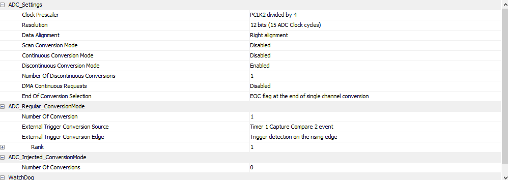

Hallo zusammen
Zuerst, tut mir leid wenn es schon einen solchen beitrag gibt.
Nun zu meinem Problem. Ich bin zu unfähig den ADC auf dem
STM32F746G-DIDCO Board auszulesen.
Hier mein momentaner Code:

Gast #5204519
Hello,
I don't use STM32F7 series microcontroller (only STM32F4 and F3) but
what I do not observe is:
- Timer1 initialization
you should use Timer1 channel 1 set to Output Compare no output and - in
Timer1 configuration tab - you should activate Trigger output Parameters
to "Enable Master/Slave Mode" to Enable and, on next row, Trigger Event
Selection, to Output Compare (OC1REF). See picture.
 - Triggering edge selected into ADC1 Configuration
you should select rising edge for trigger detection. See picture
